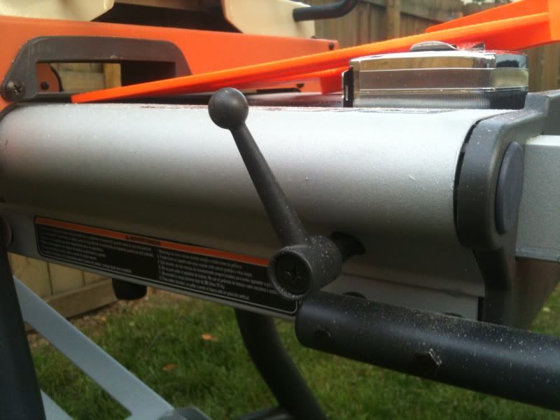

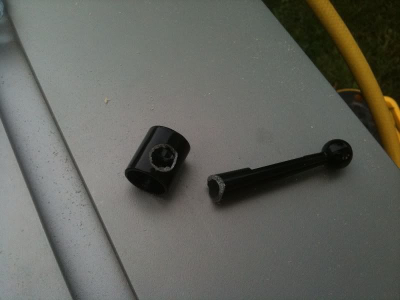

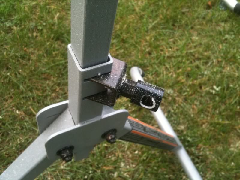

    Hello, I have two Ridgid out-feed tables / saw horses I purchased from Home Depot about a year ago and I've broken the tightening levers that allow you to adjust the height on BOTH of them!!! I did NOT man-handle them! They're obviously a lesser quality then what they're producing now, because I have the exact same lever on my Ridgid miter saw stand (which I have used many more times with no problems). Regardless, I really like the stands and would like to replace the broken parts.
    Any idea what these are called and where I can get two replacements?

        I'm thinking it's 3/8-16.
        EDIT: Just to be on the safe side, see if the stub will accept a 3/8" hex nut before you order new handles.
          Perfect!! I'll do that. Thanks!

            Here's the replacement.... http://www.ereplacementparts.com/han...si32o9insu9g10
              Re: HELP!! Where do I find this part for my Ridgid outfeed table / saw horse?
              If you think that you can get by without the ratcheting feature the original knob comes with I'll bet you could find something like this knob locally for a lot less than $10.
