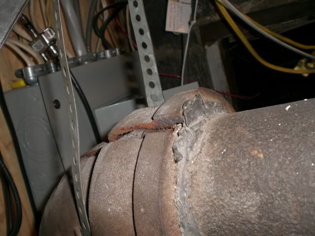

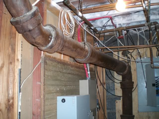

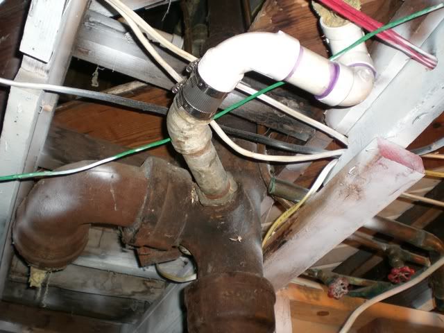

    Have a look at these pictures and you tell me. See any code violations?

    So since it is a very straightforward layout, I want to pull a permit and do the job myself (it is legal in my area). I have done major plumbing before, including a new kitchen and bath by myself on the first floor. I just want to double check my plan with some pros to make sure I'm not missing anything obvious, since this has to pass inspection.
    What I want to do is run a combo tee on its back through this existing hole (hole measures about 5" square - those water pipes are coming out too),
    giving the toilet the straight flow, and the wet vent going vertical (I know I can't use a san-tee in this position). Then using a pair of 45 degs, bring the PVC down and away from the wall a few inches, then make the horizontal run (with the bathtub combo tie in) and the 90 deg turn down, with a transition coupling to the cast iron at the floor. (as long as the bathtub drain dumps into the stack at or below the closet flange, it does not require a separate vent, correct? Would you recommend putting one in anyway?)
    The upstairs part of the wet vent will have the sink drain with a san-tee, as well as the vent from the downstairs plumbing above the sink flood line (and the bathtub vent if you think I should). I am going to use 3" all the way through the roof.

                #! no p-trap under the bathtub!! that can be seen in your pictures
                Remember this all plumbing that is exposed needs to be brought up to
                todays plumbing codes not what existed at the time your house was build!!

                      "Its amazing what they got away with 70 years ago when that piping was put in, "
                      I wonder how long your 'expert' repairs will hold up? It looks like the original work has been mutilated at least twice over the years. It's tough to balme the original installer when his work has been altered a few times. W/O seeing the structural nightmares you mentioned there's no way of knowing if it contributed to the early demise of the CI. Clueless homeowners are great for eliminating hangers and other supports, cutting through the lower half of a joist or beam and then wondering why the floor sags.
                      But I am sure you will have no trouble figuring it out. Next time you need a tooth fixed come on back and we will fix you up. You don't need to pay the dentist big bux to get your cavities filled. Doesn't take any special knowledge to fill a stinking tooth right?
