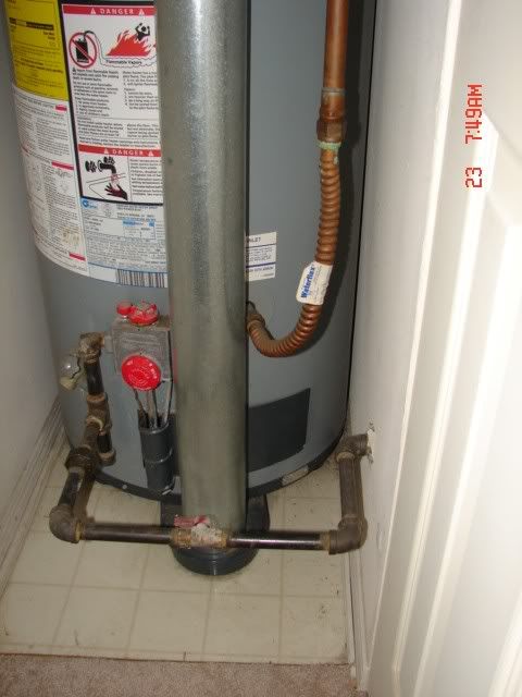

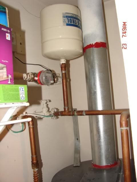

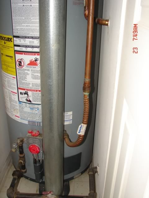

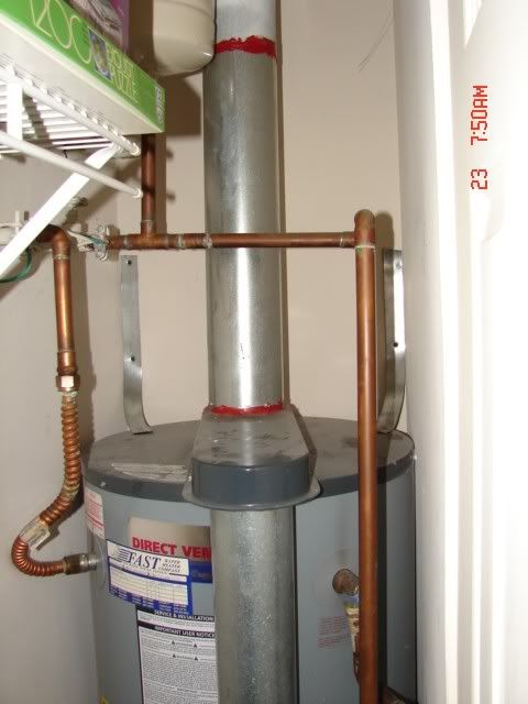

    Hi, My daughter sent this pictures about her water heater from Seattle, I am not familiar with, any help to identify and guide her to replace it? She will hire a plumber, but being an Aerospace Engineer she wants to know everything and be familiar with before the call. Is that what it is call a direct vent? How it work? It is in a comdominion. How much it will cost to replace it in Seattle? Anyone can be recommended there? I am in Arizona.

      How does that vent work?
      3-inch flue inside 5-inch pipe which brings down combustion air?

              The sticker on the water tank photo that YOU provided says: "DIRECT VENT"

                    i would say she should go with a high efficiency power vent water heater
                    it brings in outside air for the gas burner and does not use the air in the house .the exhaust [ flue ] will be PVC pipe and is because it does not wast the heat going out the flue
                    this is a good forum it is just you used your husbands name and it says he is a plumber ,so people would ask why is a plumber asking about a water heater
                    i hope this helps
                    i just put one of these in and works very good ,its going to cost a little more but should save in gas down the road

                        That said, the water heater is an older model direct vent without a blower to assist.
                        Where I live, they are no longer sold, you will DEFINITELY want a plumber to deal with it.
                        If you install a standard blower assisted PV heater and the common vent connects to other gas fixtures, you can cause serious problems, fires, or CO poisoning.
