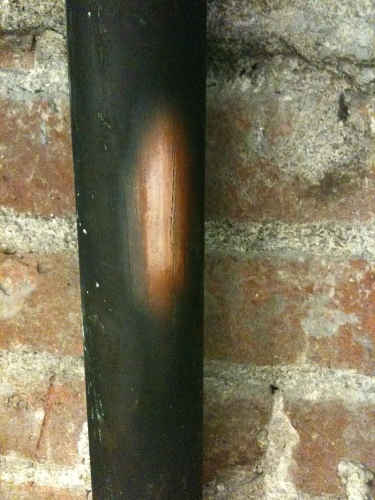

    So I took my bathroom medicine cabinet out to reveal the waste pipe and cold water main for my apartment. I took some 0000 steel wool to the cold water line to reveal the metal underneath, I assume this is copper based on the color (however, it is marked, WOLVERINE GRADE A85-15). Is this jet black patina normal? Could it be the result of electrolysis? In the picture you can see that some electric conduit is running down the same line, and I know some of the original bathrooms have galvanized supply lines to the showers and sinks.

    I'm not saying this is whats happening but I think I remember reading an article that said some sheet rock emits a sulfur and will turn metals like copper black...at any rate I wouldn't be too concerned unless somebody else knows something I don't...which is very likely...

      yeah I think bad chinese sheetrock had sulfur and other toxins in it that was reacting with the copper, but seeing that these walls are from 1950ish and made from perforated plasterboard and plaster, I doubt it. I was just curious, and was wondering if the black film was any indication of the state of the inside of the 50-60 year old pipe.

        Also, i think the pipe may be red brass (judging from the 85-15 stamp), and if that is the case it looks like they went with some good quality stuff, so I assume the black film is nothing to worry about.

          I personally don't think there's any thing to worry about...you ain't dead yet!!

            I would have guessed maybe there was a fire at some point that deposited some soot, but then I realized that nothing else is black. So, I have no idea what it is, but I don't think it's anything serious.

              I was reading it could have something to do with the condensation on the cold line and it reacting with the copper over a really long period of time. but I am not sure.

                  Worked in brooklyn and manhattan for years. That my freind is theftproofing. We used to do it all the time saved the copper lots of time they didn't know when we put it in so it lasted
                    Bingo!

                      Not totally sure about the cause of the black. I have found it on older lines, never been concerned. It has never looked in any way corrosive to the pipe, and seemed to be related to condensation and environmental conditions.

                        no offense but I doubt it, it is in an inaccessible place in a residential building. Only way a thief is ripping this out is if he somehow breaks into 5 apartments all at the same time with a wreaking ball.
                        I think it is a chemical reaction, but the new super came over the other day and was shocked to see it as well. He was thinking it was fire damage but ruled it out quickly.
                          and I think you are close, but I believe it may actually be Wolverine Tubing http://www.wlv.com not Wolverine Brass.
