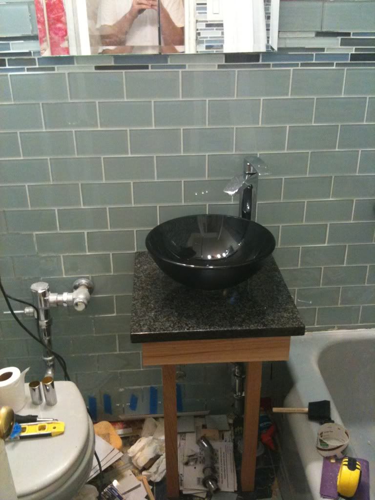

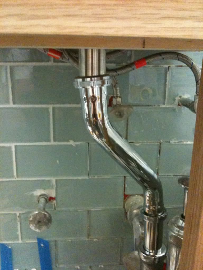

    Just put the new sink in and I was having some issues getting the waste line to plumb squarely.
    Should I just leave it as long as it is not leaking, or can I bend the offset to make it sit inline with the tailpiece?
    it is not noticeable from standing distance. (excuse the mess)

    Looks like you could just loosen the locknuts on the trap and turn the trap a little left and retighten. That should give you what you need..While you're at it you might want to replace that old sloan valve on the toilet too..

          I tried turing the trap a bit, but I don't want to break it, and it would not give.
          I actually got everything lined up a little bit better than the picture. If the offset was maybe 1/4" longer it would be perfect. I wanted to give it a shot, and if it didn't work out I was gonna call a plumber. Everything works and it is really close to fitting perfectly, I am not sure if it is worth it at this point to call someone.
          Would it be ill advised to bend the offset at the ells to make it reach a tad more laterally?

            looks like a tube trap that also has slip joint nuts. the trap should be able to get loosened and then you can swing it as old1 has suggested. it's up to you and if it's not leaking, and you can't loosen the trap, then leave it. honestly it doesn't pay to call in a pro for something so slight. if it was leaking, then that's a different story.

                  this is the before, it is actually closer but a bit higher up on the wall, also, the corner is rounded off. The new sink is actually an inch or two farther from the toilet.

                    Looks like a 1 1/4 chrome tail piece soldered into a brass solder ring. If the chrome tail piece is in good shape I take a 1" x 1 1/2 black fernco and use a trap adapter and chage over to pvc. The 1" fits nice on those chrome 1 1/4 stub outs if it is solid. You could also take out the brass solder ring and screw in a male adapter and change to pvc. You might have to add a PVC fitting or 2 also if the trap swing does not make it. I believe its 3 1/2 inches or so. This is if you want to change it over or maybe you want the chrome look. Its all about what you like and and does not leak.

                      It must have had an offset on the old lavatory also??? It looks like they just roughed the lav in wrong to me from the jump. It looks as if the lavatory even the old one would be hanging into the tub if it was installed without the offset tubular. Is that a lead arm in the wall?
                      Yeah you can see the old offset on the ground in my first pic. Not sure why the waste line is not in a proper place. The building is 100 years old then redone in the 50s or 60s then again in the 80s. Not sure if it is a lead arm. Pretty sure most of the waste lines in the building are galvanized.

                        looks galvanized..You could probably spin the chrome trap off the nipple and turn the new trap to the left to straighten it out..Only issue is if the nipple spins outta the wall..Again no biggie just replace the nipple with the same length..Yeah looks tight in there but that's all you got so that's all you get..
