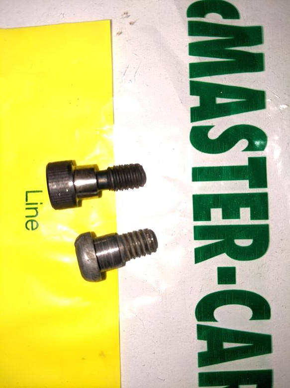

    I couldn't find anything locally in specialty hardware stores, so I looked online and found the shoulder screws on McMaster per your suggestions. I hesitated to order because to order 2 screws the shipping was like 5X the cost of the screws LOL. So I sat on it for another few weeks and finally placed the order, and by the time they arrived I was busy on other things and didn't get a chance to try them. until one day I saw two screws in a miscellaneous parts drawer and I was scratching my head..."oh yeah, those are for the tubing benders" so I tried them out.
    They worked fine but they "bottomed" before tight against the lever, they were may be 1/8" to 1/16" too long, so I took out my angle grinder and grind off a tad and that worked.
    Again, apologies for not reporting back sooner.

    I have a question for those who have used these old copper tubing bender made by Imperial. I think they are called the 360-FHA tubing bender.
    The set comes with multiple rounded form wheels, one for each size 3/8", 1/2", 3/4" etc...and there is a pivoting "hook" that is secured to the wheel with a screw.
    Click image for larger version
    Well, out of the four wheels I have, two of the hook screws have broken off. These screws take a lot of shear as you bend the tubing with the hook sliding around the tubing as the handles are cranked.
    I am trying to find replacement screws, but these are not standard screws, because it has a round shoulder under the screw head that fits the ID of the hook exactly.
    Anyone knows if these screws are still available somewhere? Or if they may be "standard" screws if I know the specifications?
