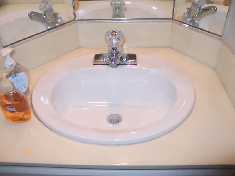

    This is another vanity I will replacing with granite. I’m not familiar with the material and how to remove it. Here is a pic –
    It looks yellow in color. I banged one of the splashes with a hammer. It eventually broke and some clear pieces came off. Those pieces look and feel like plastic and did not feel very sharp. The material is not shattering is I expected.
    Any suggestions how to demolish it

    It appears to be cultured marble which is a mix of resins and a cementitious material.

      Thanks - any tips on the best way to remove it.

        Pop the splash pieces off with a SuperBar backed up with a piece of 1X2 or plywood to protect the drywall than lift the top off with a little help from the SuperBar.

            They came off nicely with the use of a prybar - thanks. I've now templated and cut the granite off the template. I will rod it tomorrow.
