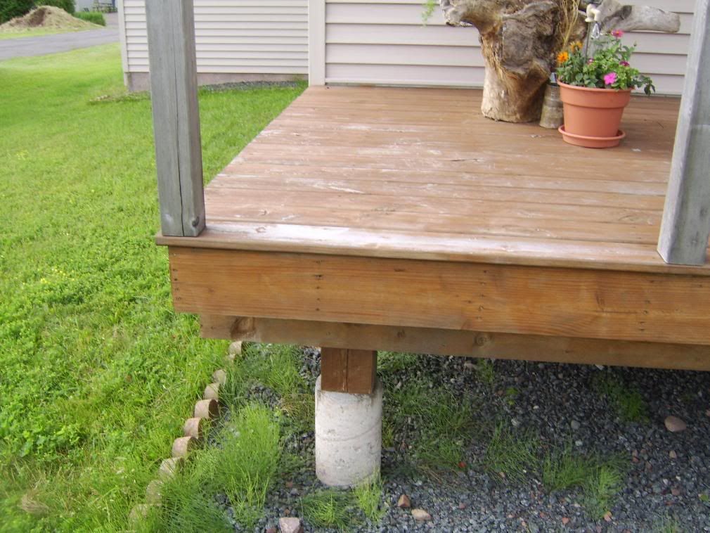

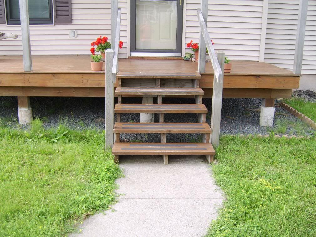

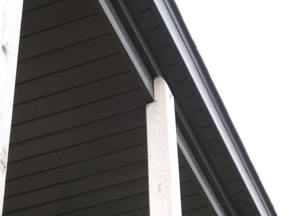

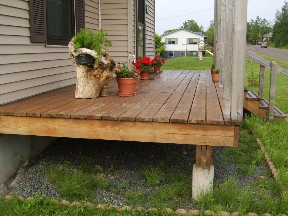

    I am redesigning this front porch, some ideas would be nice. The top of the posts will have something to drop the look around 3 ft., this way the posts don't look so tall. Join in, give it a shot, small ideas to big ideas is fine with me, of course as most projects, money can be an issue. I am looking for maint. free materials.
    Pictures, drawings, name brands of type material, etc. I'm looking for creative ideas, the porch will not be an enclosed porch, it will be left open,. Also no round columns because we do not live in the South....

            the posts distract, too many, too long. Vertical distance is an issue.
              Re: Redesigning Help
              take out the post put in bigger ones on the ends with a new beam ,this will open it up
              the deck looks good just needs a railing
              and close up the stairs and the bottom of the deck

                Yes there are way to many posts involved here and they will be thinned out.

                  Are the joists in the ceiling over the porch cantilevered and sufficient to carry the roof?
                  Or are those porch posts load bearing?
                  Either way I'd pull the two posts on either side of the stairs.
                  Double or triple the width of the stairs (which will require widening the walkway as well).
                  Do a standard rail/baluster but MOST IMPORTANT with this height of porch is bringing the roof line down in a way that balances/matches the railing.

                    i was going to say to re do the stairs but the walk way would have to re done like you said ,it would look better with larger stairs it will say main entry this way
                      I agree with Dairylander with the possible exception of widening the steps to triple the width without knowing how the home owner will be using the porch. If they plan to sit out there, tripling the stair width might take away from chair placement. I think those posts should be made to appear more massive either through replacement or encasement. Get rid of that storm door and the cookie-cutter, Stanley-type entrance door, replace it with something - I don't know what, but it should go. After door replacement add a coach light to the left side. An inexpensive way to make the roof line appear lower would be to suspend hanging flower baskets from the ceiling.

                              Bring the top down to about the 7'-6" level, bring the railing up to railing ht and cover both with siding. Change the color from the window wall out to make it pop. I like the idea of making the stairs wider but I do not see that fitting the budget. Do remove and put in some thing made out of stone or concrete to give you some tecture out there. Maybe some iron railings and matching iron in the corners of the upper dropped section for a little detail.
