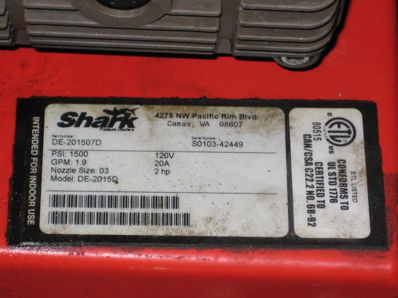

    So I picked up this electric pressure washer at an auction Saturday. It was a steal. I paid $190.00 and it came with all the paperwork and extra parts. I could not beleive that all the parts were there with it still. It apparently is a high end washer used quite often by professionals and rental companies. I found the same unit on the net selling for close to $800.00
    I need to get this set up for small jet jobs right away. Do any of you have suggestions for hose size and length, what type of reel and a nozzle kit. I have found where to buy most of the parts i need such as a conversion kit but some of you may know other places for me to look. Any help would be great.

          here is the problem i see with that machine.
          it's nameplate shows 20 amps. i have 2 electric units that show 17 amps and they both trip a 20 amp breaker under load.
          truthfully if you need a generator to run that unit, i would just as well purchase a 5.5 or 6.5 h.p gas pressure washer unit. 6.5 will get you approx. 3gpm at 2500-2700 psi. no extension cords and a gasllon of gas will last hours.

              I am a bit concerned about this as well. I was going to give it a try and see how it works. I am confident that in most commercial kitchens i can find a good outlet that will give me what i need.
              I have used electric jets in the past that would almost always pop a breaker on residential but were less likely to do so in a restaurant.
              For the price i may as well give it a try don't you think?

                got nothing to lose.
                residential will be an issue.
                commercial kitchens should have a 20 amp outlet for their counter appliances.
                just make sure you have a backup plan if the breaker does trip. as it gets hot the breaker will trip even faster.
                still the electric will have limitations and not sure a commercial kitchen will benefit from a small jetter.
                so now you have the large and small jetters.
                what you need is a good midsized machine. try 5.6gpm at 3500psi. 18h.p gas will do a nice job up to 4'' some 6''.
