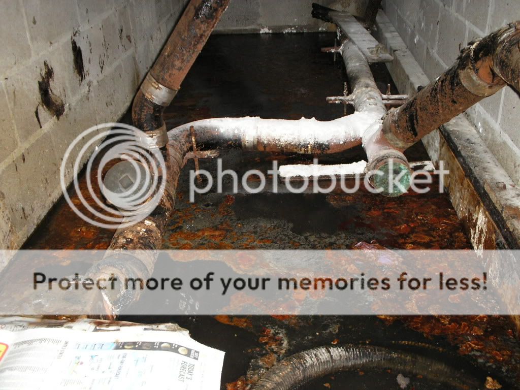

    I thought this would be a fun one to share. So I pulled out my camera last Friday.
    Vacuum truck service sucked out the trap and let them know the outgoing line was stopped up.
    I removed the 1/8 bend instead of going through the clean out to make sure I wasnt missing anything. I wanted to make sure this one didnt recall.
    The greasetrap was left open and the six inch deep floor of the crawlspace filled with the most delightful smelling grease. Engineering later pumped the area out.

            Curious, why not use the jetter for this? Did you use the "extention cord switch" trick to run your machine? They cleaned the space really good, how'd they get the crawlspace cleaned? I never mess with the C/O plugs in those situations, I'll disconnect it at the no hub. Never found a metal c/o plug that came off easy.

              it looks like the outlet pipe from the grease trap wasn't supported properly.

                      Curious, why not use the jetter for this? I only jet when the cable with blades wont work. Did you use the "extention cord switch" trick to run your machine? Yes, I didnt feel like going back down to get my foot switch. They cleaned the space really good, how'd they get the crawlspace cleaned? They were setting up a sump pump as I was leaving. Earlier the greasetrap company had emptied the space but it filled back up by the time I got there two hours later. I never mess with the C/O plugs in those situations, I'll disconnect it at the no hub. Me too. Never found a metal c/o plug that came off easy.

                      it looks like the outlet pipe from the grease trap wasn't supported properly. It could probably use some extra support but it has held up since the 80's.
                      just courious, were you concerned about confined spaces issues? Open to garage with blowers and fans circulating
