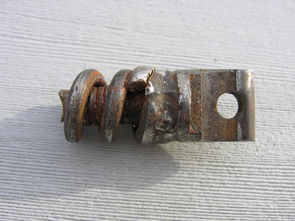

    When my 3 week old .55 cable broke the cutter was still turning. It was stressed but didn't seem to be under too much stress. It surprised the hell outta me when it let loose
    The way it broke, does anything look odd ?

    Is that the one you were trying to retrieve the rest of? Def. looks older than a 3 week old cable
      Yup that's the one and you're right, it's about 2 months old. The cable running behind it is 3 weeks old I got them mixed up

        Drano can cause this over time, just matters how much is in the line and if you wash it off when the line is cleared. Usually there are pits, cracks, or white spots on the cable.

          Looks like someone over heated the cable when they welded/ silver solderd the end on and took all the temper out of the cable. I have had ones look like that when I first tried to repair cables. I wasn't keeping the cable cool enough and was trying to weld the end on so it never came off instead of spot welding it so the cable wouldn't unscrew from the cable. The old EEL cables never had a spot of weld on them and I never had a cable unscrew from the end. Looks like a case of over kill.
            In which case the whole cable may be compromised. Take a real good look at it.

              Acids does that to cable but by the way the winding looks, I got a feeling you got a bit to much torque on it. That magnum cable builds up torque a lot faster than standard cable. My brother snapped a few till he learned that the torque curve is different.
                Ron is dead on. Been through some acid and not rinsed. Definitely over torqued maybe not this use. At any time were you running in reverse?
                  I'm not sure where the acid would have came from and I almost always run water through the line as soon as I get it open.
                  I've been running the .55 cable for close to a year now and thought I knew how far it could be pushed
                  I only run in reverse if I get hung up.

                    Maybe there was always a weak spot there/ bad weld etc..We need to send it to the forensics lab for further investigation..
                      I've been running the .55 cable for close to a year now and though I knew how far it could be pushed
                      Who knows.... I guess your not a true drain cleaner until you have gone through the ropes
                      Dude it happens...much like $h!t....I had a brand new cable once and I put it in a clean out and the head snapped right off the bat...reached down and pulled it out and went to my welder buddy...used that cable for about two years after that...sometimes there's no rhyme or reason....

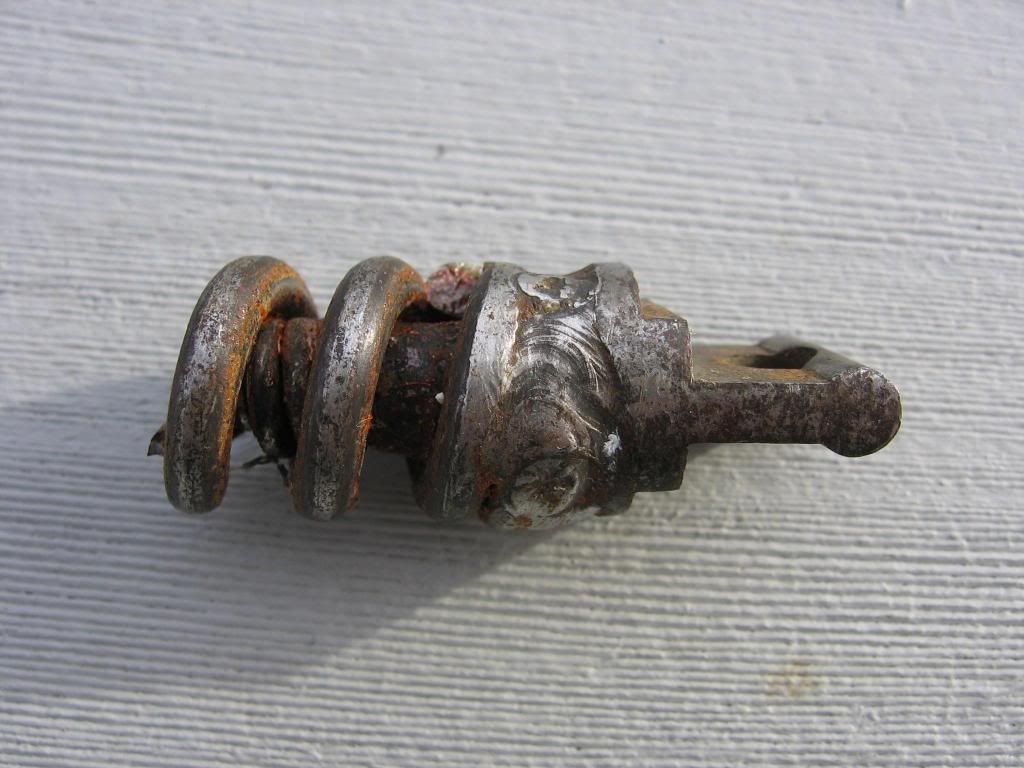

                        I don't know.. to me the second picture shows there might have been an issue with the weld
                          It very well could be...also it does look somewhat rusted and pitted from possible chemicals..could be a little of both...i know when welding this stuff a good welder makes a huge difference...I tried one other welder once and it was awful...the welder who does is now is a muffler shop welder...in the end it does suck that it happens...
                            I don't know.... I thought I would take some pictures and throw it out there for you guru's to look at.
                            It just blew my mind when it snapped while the cable was still turning after grinding away on a blockage for a few minutes.
                            Even the home owner was like WTF !!! He could also tell there wasn't much stress on the cable when it went.
