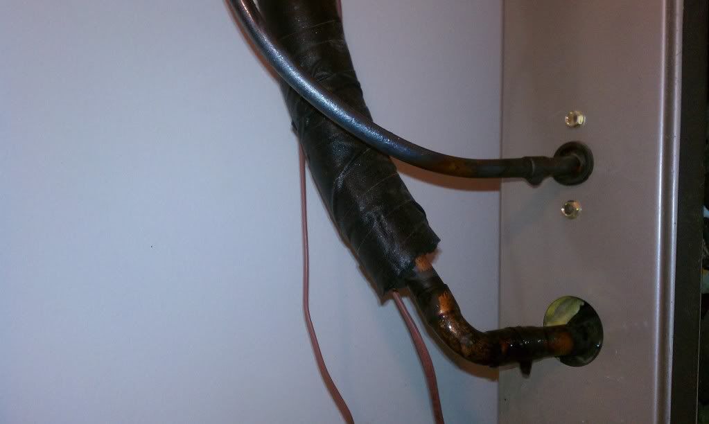

    Here is an install of mine that may end up in litigation unfortunately...
    Background: New Construction (Habitat House) Ultra tight design (R30 Walls / R50 Roof),
    The coil pictured below is 12 months old
    Notice the Color of the Liquid Line feeding the Evaporator (The suction line insulation was removed just before pic taken)
    All of the exposed Copper is being attacked by formic acid formation

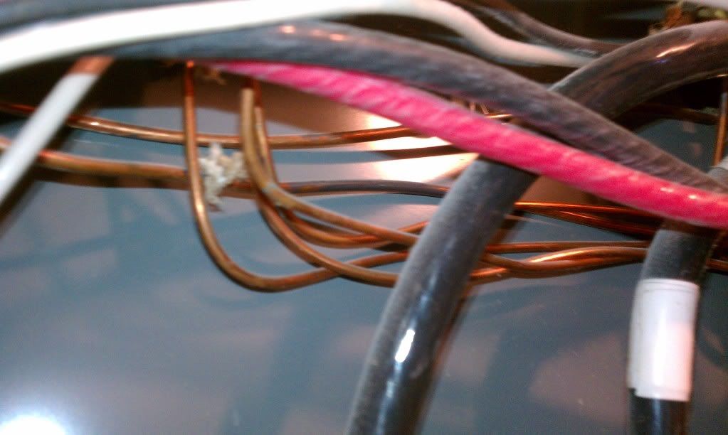

    (Here is a view inside the electrical panel notice the black starting to show up...)
    The Rinnai tankless Heater is also showing the blackening (which is the tell of formic corrosion)
    The Smoke Alarms keep going off in the house as well (replaced multiple times)
    The source of contamination is a dry floor drain (installed without any type of primer) and exaggerated by the tight nature of the construction and a negative pressure inducing exhaust fan.
    FYI and be on the look out:-)

        Dry floor drain? Like a typical floor drain in a basement in case of a water leak? What's gettin' drawn into the residence to react with the copper? Great pics!!!

          So it's been determined that the Formic acid is coming from the dry floor drain? Seems unlikely to me. That much contamination in such a short time is probably internal. Carpeting, drywall, insulation, cabinetry could all be leaching formic into the atmosphere. I hope someone is monitoring CO levels in there as well.
            Re: Formicary Corrosion
            There was an interesting article in the HVAC News magazine some time ago about Chinese manufactured drywall corroding all exposed copper in homes. I'd be looking at items inside the home as well like stated above.
              Do a search for formic acid. I found a really good article from hydro-temp.com. Lots and lots of possible causes inside a home.
                The current train of thought is that the dry traps are allowing sulfur compounds into the area and those compounds are reacting with the copper.
                I do agree that it could also be one some or a combination of all of the building products used on this project as the effects are not localized but have appeared all over the house.
                I was told last week that I was going to be taken to court over this because of my faulty equipment and because 410A refrigerant eats copper
                I think the Habitat folks are calming down now and are realizing they have a big problem with this house, the copper is just now showing it to them...

                      Another Company came out and told Habitat that there was a leak in the coil which released the 410A and it was the 410A that caused all of the copper damage.
                      How do you explain to Habitat who is just looking for someone to blame that the second opinion they hired are retarded.
                        Tell them what the gauges will read, show them, then say it. It couldn't have been an HVAC company. It would be good to document this now that people are throwing the C word out. I would cover my rear just in case. It is one thing to say it didn't or couldn't but to show proof of no leaks, that's another.
                        I have seen sewers run in copper for years and only find that the ones on a septic tank have problems. I was called out to a house getting ready to be sold. I wasn't called out by the owners because they somehow didn't smell it but their agent did. I went in and told them I found their odor problems. They used copper guttering instead of pipe. Once there eyes quit bugging out of their head I showed them how the septic gases ate out the top of about 15' of their sewer line.

                          The reason I was called in the first place is the A/C was not cooling properly (I installed the system), The system was flat, I found at least a dozen separate leaks under the tree bark on the evaporator coil.

                              I though I would update the story a bit and update the Pics for everyone's benefit.
                              The local gas company contacted me yesterday, they were at the house investigating a gas smell. No leaks but they decided that the Tankless water heater was improperly vented so they capped the gas supply to it.
                              The tankless water heater is also being attacked by the corrosion (The black pipe on the left is actually copper)
                              Here is an example of what the electrician is seeing when he removes switch and plug covers. (The grounds are disintegrating all over the house).
