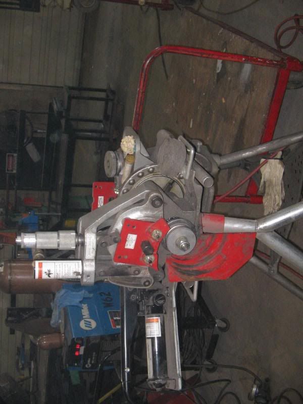

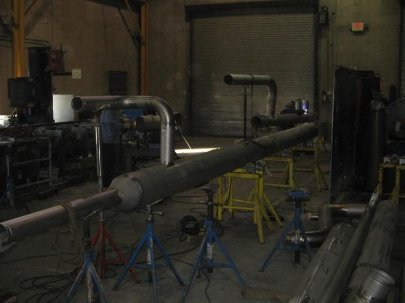

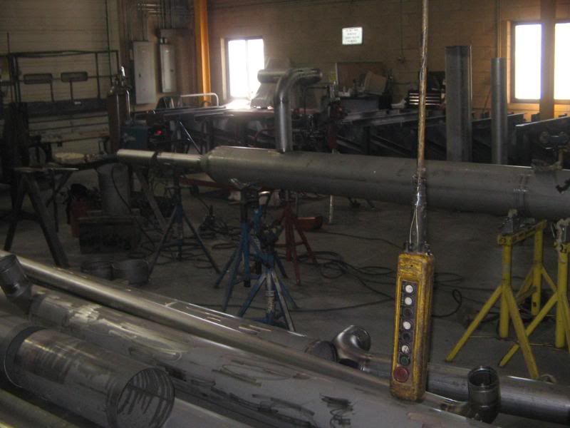

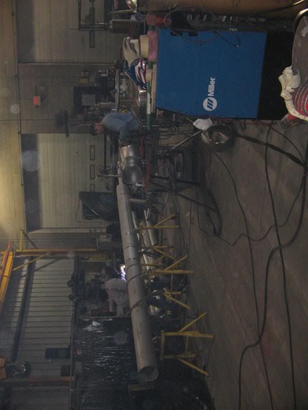

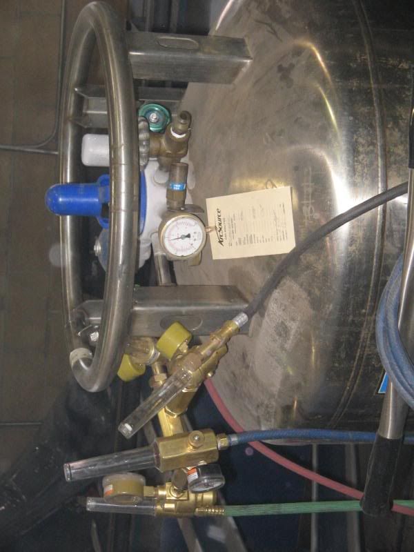

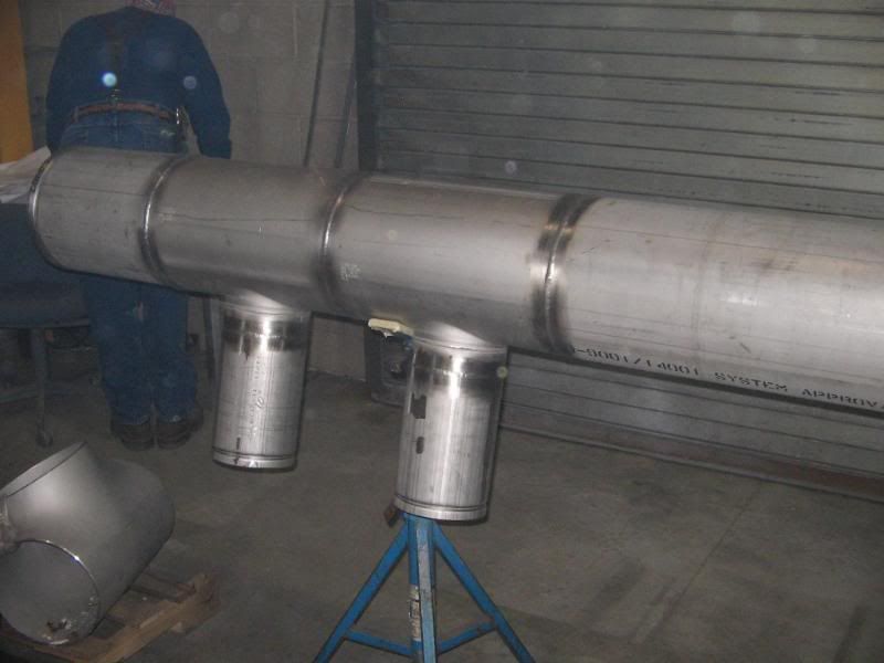

    Sched10, 304SS, all back purged, and TIG welded, some Victaluic(sp check) ends as well.
    Back purge machine
    Vic machine, mounted on a 300 if you must know
