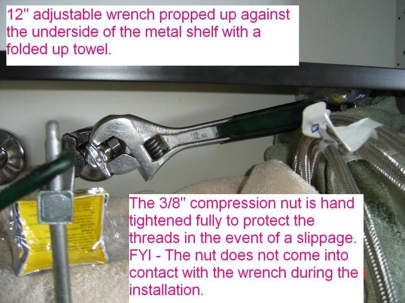

    I'm posting the pics on my technique.
    Ben had the idea of using a crowsfoot wrench, which is what I would have used if my crowsfoot set went up that high. The largest crowsfoot I have is a 3/4".
    Usually I use a 12" adjustable wrench and a 15/16" open end wrench to install my angle/straight stops.
    I have a difficult time using those Pasco & Ridgid stop wrenches, not enough leverage for me.
    [/IMG]
    [/IMG]
    The RIDGID basin wrench worked almost perfectly for this because the 5/8" compression nut is nearly the same size as a Lavatory supply nut. However, the chrome finish on the nut was marred slightly from the sharp teeth, hence the reason why I would have preferred to use a crowsfoot wrench instead.
    Again, Thanks for all the great comments!
    Tracy
    Re: Angle Stop Install inside a Kohler Cabinet
    not that i've ever installed an angle stop inside of a medicine cabinet.
    but i've installed my share of stops inside of very tight cabinets when i'm a day late. even inside of ice maker boxes when they didn't come factory installed.
    i've found that the pasco combination 15/16'' x 5/8'' ratcheting wrench is awkward as it's 2 sided design is not productive when you do production work. i do like their angle stop helper handle. this is the one that has a 1/2'' slip joint and 3/8'' compression thread on a 6'' long reversible handle. this allows for holding the stop in place without marring the finish.
    i do use a 15/16'' ratcheting angle stop wrench. similar to the pasco, but without the combination 5/8'' on the other side. the wrench is approx. 7'' long and it's got enough leverage for both new installations and removing old stops.
