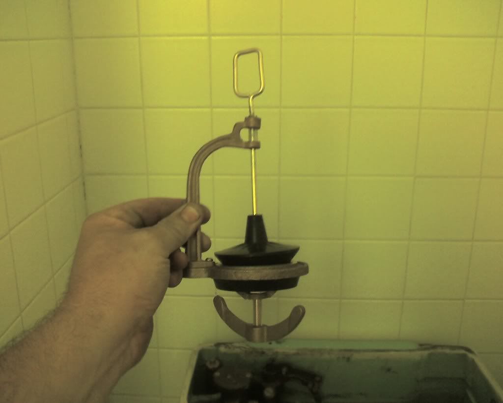

    I thought I would post these just for folks to see...
    I had never seen a Case toilet before, I had alot of fun learning this bugger today...
    The part I'm holding is the flapper assembly.
    Enjoy,
    Okie
    Re: Case Toilet Pics (FYI)
    there about as much fun to work on then the american standard ventaways, the case 50 ballcocks, 62-8 used to give me headaches to work on when the ballcocks were still avaiable they were extremely expensive and very challenging to get to work right. the first one piece by case had a kidney shaped lid circa about 1930 and if i remember the ballcock was a t/n and the float ball looked like a pan and i belive that preceded the advent of the case ballcock sometimes in the 1920s, they also had a two piece model were the tank was secured to the bowl by one very large bolt. anyways good find and good history.

      This bugger is the "Rube Goldberg" of toilets
      I spent about 2hours tinkering with this tempermental jewel and consider it well spent learning time.

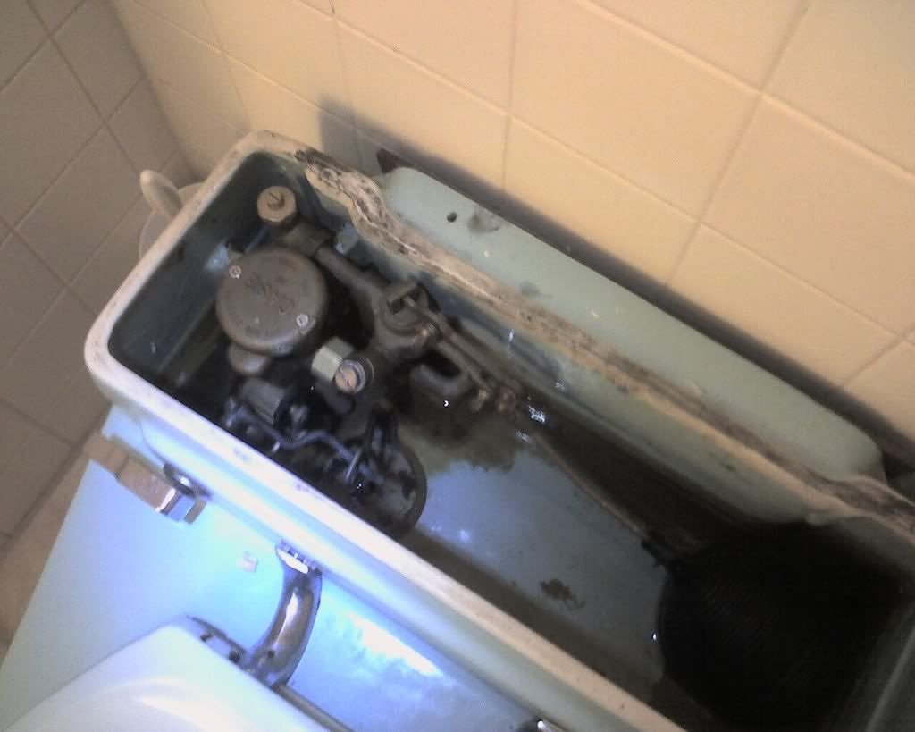

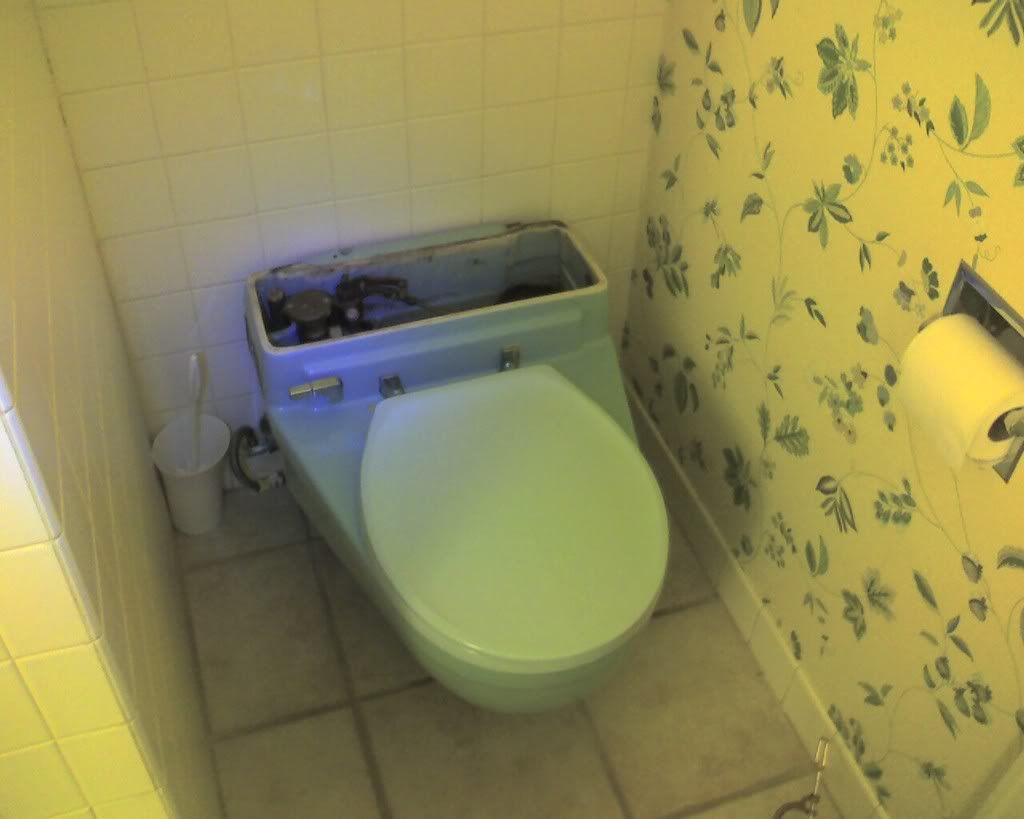

                              I had to laugh when I saw this post. I took some pics last week of a Case 50 because I was having problems with it, so I was going to post it here for advice.
                              Problem: the tank ball won't fall correctly, it will hang up right on the rim of the flush valve seat. I generally use a Triple Seal 3" for these toilets. In fact, the old tb that I removed was just that. The old one was working fine until the threaded adapter ripped out of the top. All I did was replace the tb with the same and now it hangs up. (Usually not until after I've left the house). Last year I replaced the handle, linkage, lift wire and rebuilt the ballcock.
                              Finally, yesterday, I replaced the triple seal with a fluidmaster bulb that I've never used before. It appears to be working fine. Time will tell.
                              The first two pics are of this problem toilet. The last three are of the one mentioned in the first paragraph.
