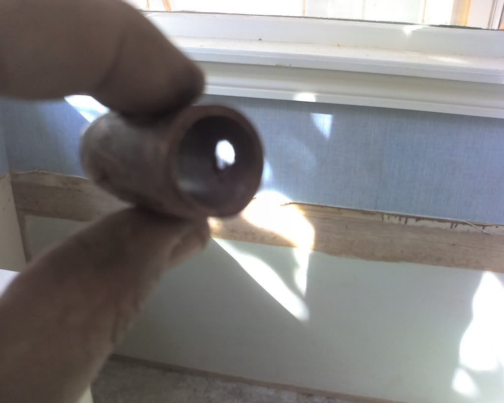

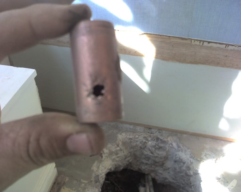

    I am still stumpped on this one.... I'm gonna guess lightning
    This pipe has been in the ground for 50 years... I did not clean up the pipe in the photos except to wipe it off and the pipe looks perfect inside and out except for what is shown...

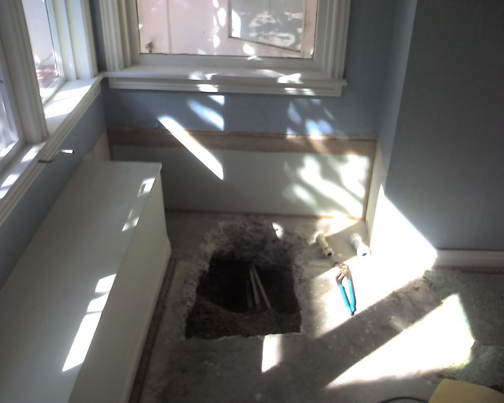

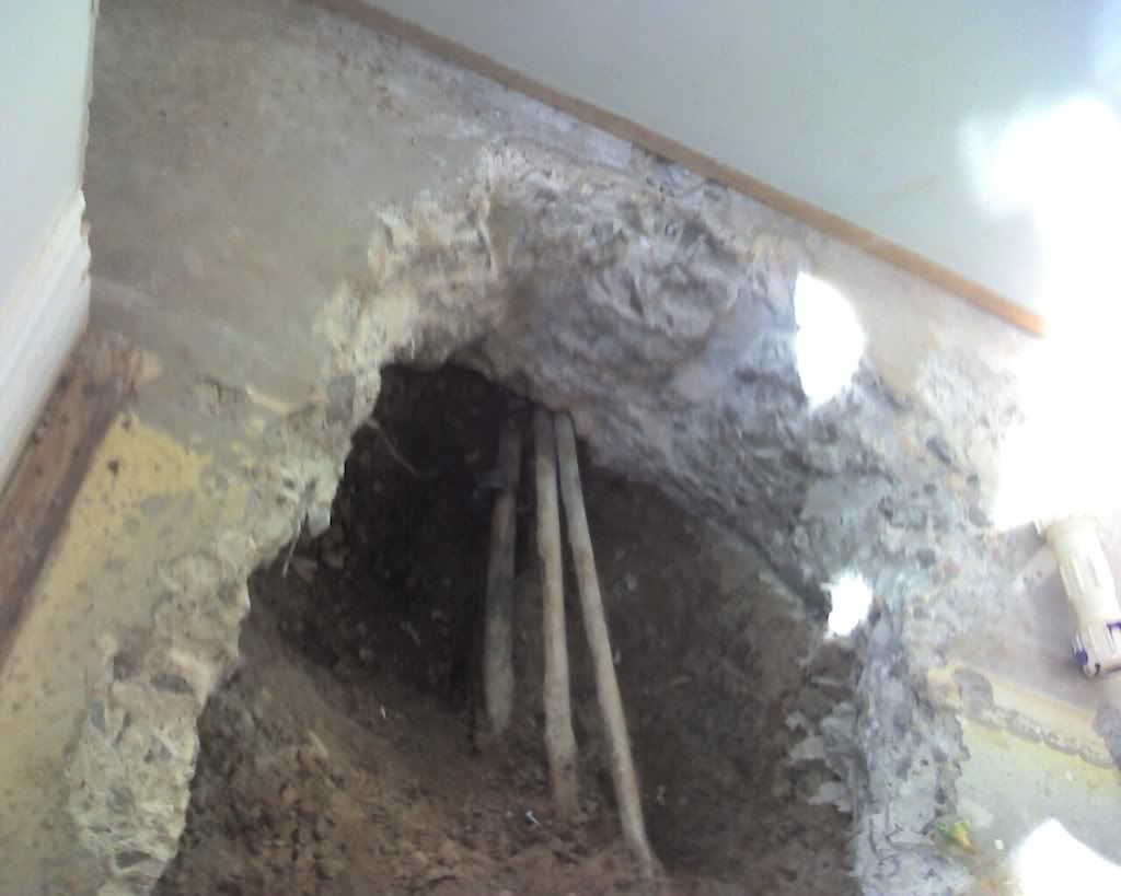

      Please PLEASE tell me you're not going to use those couplings to the right.
      There's only one true repair on that connection...
        Re: Lightning Strike? ( Pics)
        Yup is gonna get a dresser until the customer decides how deep the repair hole he wants or can go...
        Relax guys is a temp fix
        I expect this line to be replaced the question is am I just going to do it or the whole house at the same time ( Repipe through attic)...
        Dresser under concrete who do you think I am Devine Plumbing!!!
        The Shame!

                You are allowed to mechanical joints underslab?
                You lucky dog?
                  Slab plumbing is my worst nightmare. Full unfinished basements are a plumber's friend.
