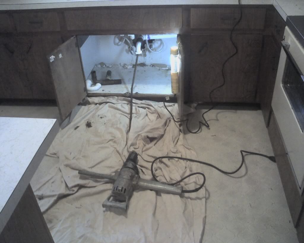

    K60 would not spin it...
    Drill would not spin it...

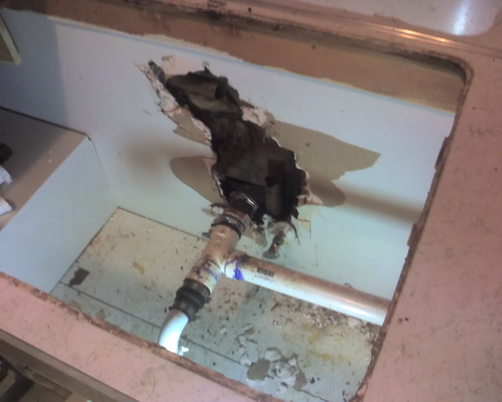

    Pulled the sink and put my back in to it.... With the owner watching me she popped like a spring ( I had a drop cloth wrapped around it when it broke)

      Now whatcha gunna do?
      • #18
        Re: Not my cable (Pics)
        Concrete saw and jackhammer...
        I kinda thought it was going to end up this way but I had to try getting it out first.

          Is that a tight wind 5/8 cable? How old is your drill? I'm suprised Steve hasn't posted his 2 cents on a sectional cable failing.
          • #20
            The cable is an open wind 5/8" sectional cable (standard K50 cable).
            The drill is about 40 years old, Works well. (I bet Rick has 4 of them :-P)

                    The line you see comming in from right to left under the kitchen sink is the relocated washing machine drain line from the garage.
                    I am going to take pride in ripping all of this hackjob out and making it right...
