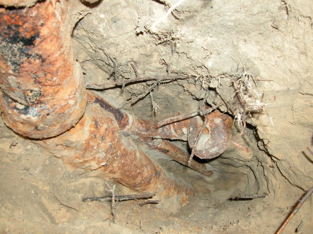

    Here we go tunneled 12' under a House and Found This ... Got to cut it out and Re-do in PVC .... The cou'de Gras (sp) is a sanitary T on it's Back smack dab up against the Bottom of the Slab !!! (Vent Stack) Trying to figure out How to Cut it out !
    What's This Job Worth ? ................................. Dave

                          Gear here is the Deal ... The 4" will be snap Cut No Problem ... Already Did the Cuts on the Small stuff ...
                          Will Probably Have to Cut the San T at the base of The Stack With an angle Grinder Then reline the 4" stack with 3" (Nothing Enters the stack)
                          As far as Pricing goes Will Probably Go Time and Materials Then Throw in about $250.00 For All the Sand packed in every Crevice ... Ears Hair Face Mouth Etc ... + general Aggravation ... Just Wanted to get a Consensus of the Group ...
