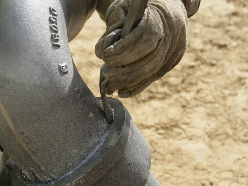

        Someone asked about the bands (couplings) in an earlier post. They're Duriron MJ (mechanical joint) couplings and are the only approved system for joining Duriron hubless pipe.

          A few questions:
          1.) What runs through the lines requiring this system?
          2.) Why are some sections mechanically coupled while others leaded?
          3.) Do they have inspections on this?
          Just trying to learn.

            Duriron Underground; What I learned:
            I made this post to give the folks that may never have been exposed to this product or this kind of work an idea of what it's like. Obviously some of you have been around this kind of work before and appreciated it too. Thanks for the compliments.
            I realize it's not an end all instruction to underground/Durion work, in fact far from it. Like I said, it's just to give people a peek at what goes on. It would be incomplete though without a few words of caution that I learned about the product during this project.
            • Duriron is heavy & fragile. I suggest treating it as glass
            • Duriron is very expensive, not readily available, and has a high restocking fee. Order accordingly.
            • The acid resistant oakum is the same as above. If you run out, figure it's three days away, minimum.
            • The MJ couplings have a SS band, the gasket material appears to be Teflon with a coating like latex on it. The coating comes off very easily, Duriron says the couplings can't be reused. At $35 - $50 a pop, we found them hard to throw away but most weren't suitable for more than one use.
            • Document damaged received goods like you have never before, like I said, it's expensive.
                It's a lab in a refinery/chemical plant. I imagine if I asked them they wouldn't say. They're pretty hush hush when it comes to their products. Any of the Polypro systems would have been chemically resistant enough the owner just has a thing about plastic under a building.
                Mechanical couplings are only available for Duriron up to 4", we had some 6" in our system. If we'd made it all bell & spigot, we'd still be melting lead!!
                The owners, engineers, and general contractor each have a QA/QC dept that looks at all the work.
                4.) And what did you use to cut on this job?
                Regular cast iron cutters. Duriron cuts very easy, it fact, it's almost scary!
