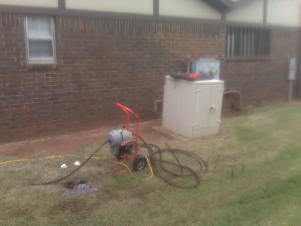

    My K-60 finally could not get the job done (first time this year)...
    16 apartments (2x 8 units) both dump into a 6" , I was concerned about overdoing it and flipping the 7/8". Light roots caused a large soft stoppage that I turned into milkshake.
    The tenants were entertained and impressed with the K-1500

    correct call.
    i would have used my 1.25'' cables too.

        Outside CO like that I rather use my 1065
          Re: I had to go Big
          Spartan 1065 is a great machine but way to much machine for a one man operation to load and unload (with my truck set-up).
          The 1065 is a dream to run but I really like having the cable feel of a sectional, though I have a couple of smaller drum machines for indoor work.

            what about a jetter?
            the only dumb question is the one that is not asked!
              Re: I had to go Big
              Whats this new fangled thing you call a jetter? Us old timers like to use a flat tape with a big ball on the end. And if there is a lot of sludge we tape on a watering hose to the flat tape.
                Re: I had to go Big
                What about a jetter?
                I'm sure a properly sized jetter would have worked just fine in this situation if I had one...
