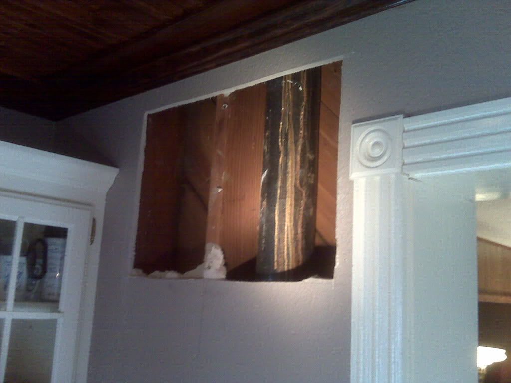

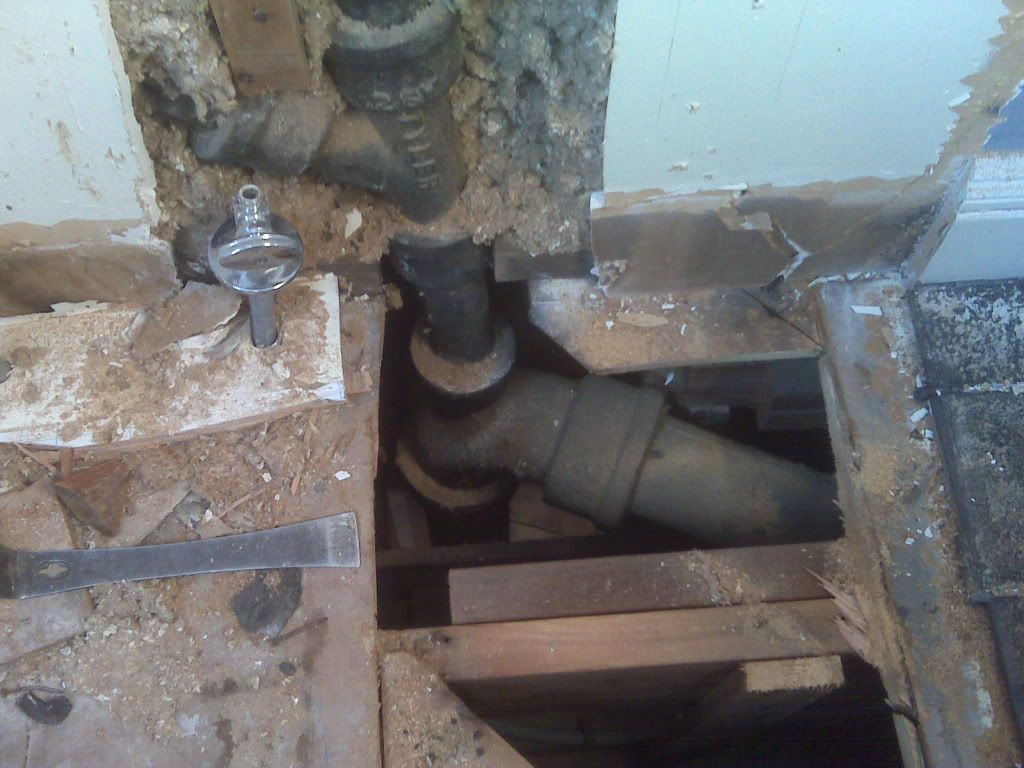

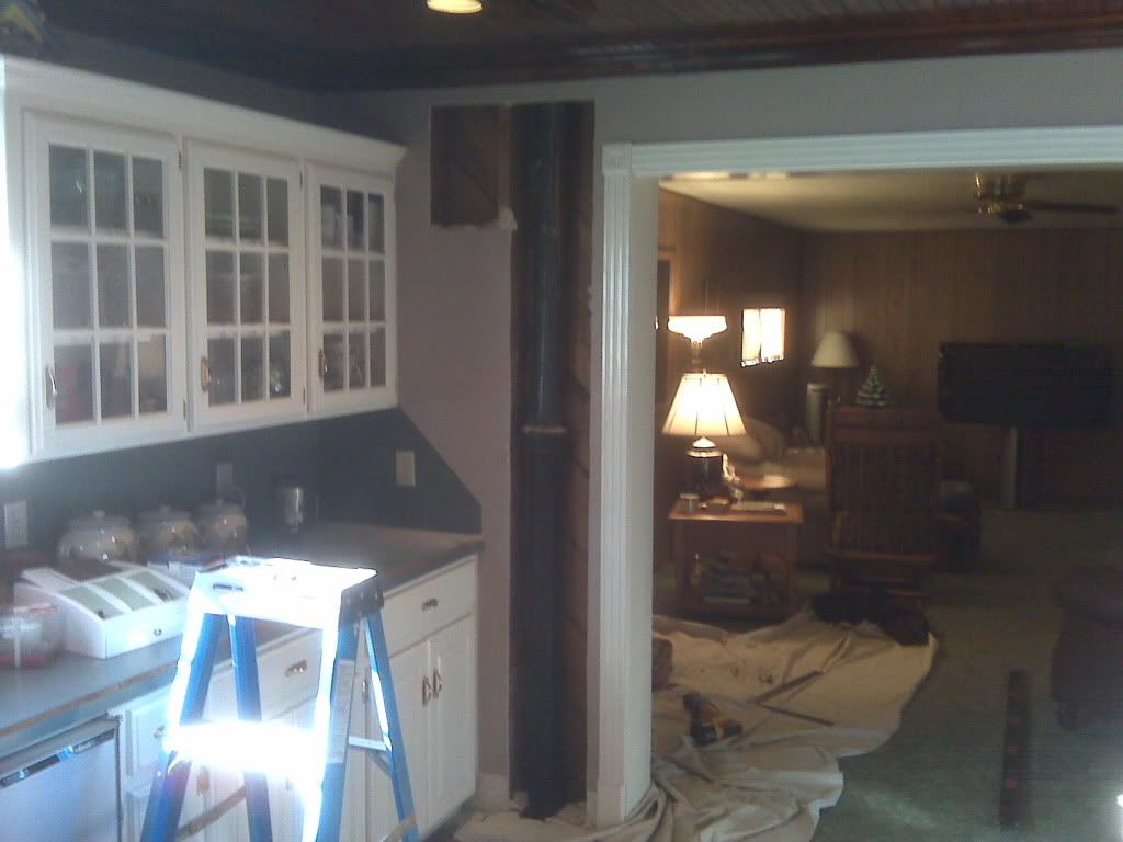

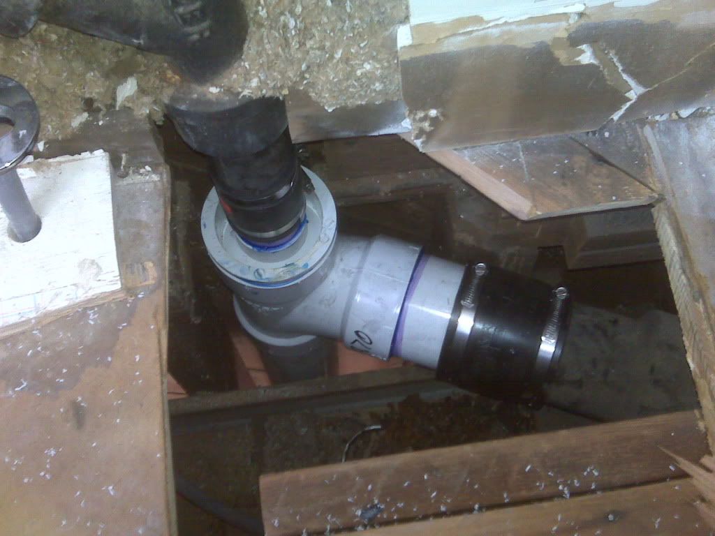

    Last weeks fun project in "Hacktown". 4" CI run to upstairs bathroom section inside wall split lenghtwise through the hub. The sheetrock guy and the painter should be done with it tomorrow ( This house is 102 years old but I don't beleve this particular cast is that old)
    (Upstaris Bathroom: I had to pull the vanity to get to this)

      I'm sure I will get a few flames but it's OK I don't feel to bad since there is no weight on the upper connections a Fernco will work just as well as a nohub IMO.

        Your're probably right about the Ferncos being just fine.
        All the inspectors by us want the "Husky" no-hub couplings inside (the 4-ring/bolt variety) on cast to PVC connections and a No-hub adapter on the PVC. Kinda overkill, but you never get leaks that way. I personally leave the Fernco couplings for underground and I'll use the "no-shear" variety on horizontals. I don't mind spending the extra $$ for them and the nosy customers are usually more satisfied with the shiny metal as opposed to the "rubber bands".
        Course I also live in an area where leak and oakum joints are required for all above ground commercial cast iron jobs! The town that my shop is in actually does not allow PVC at all, anywhere, not even residential!!

              Looks good but would not pass here in Minnesota. Fernco's (rubber ones with clamps) are a big no no, would not pass inspection. No hub bands only.

                  why didn't you use no hubs? when i don't it's because i'm 1 1/2 hrs (round trip) away from the supply house. breid.................

                    On some hubbed cast , I will use a fernco if the no-hub dosent fit tight

                      Ever try a Mission CP-44? The fatter side snugs down to service weight without crimping the stainless band.

                        I will say I LUV fernco's. I don't like having glue and primer even clear primer in a finished house. I probebly use them more than I should. Just because of no mess. Now I think all of us with cameras know how bad ferncos and no hubs are under ground. I always see them shift when they are underground. I think no hubs would stay inplace better if they were longer. But I believe they are to short.
                          You can always use these'
                          http://www.anaco-husky.com/huskySD4000.html
                          or these,
                          http://www.siouxchief.com/Support/DW...Tomahawk.L199U
                            Re: 102 Year Old Cast Repair Project
                            I think a coupling like that would be much better. I'm suprised that isn't code. I don't think the powers that be know how poorly most elastomeric couplings perform under ground. I wanted to start a thread about this. It's another product that just doesn't work great under certain conditions. How many people with video equipment will support me?
                              We use the Mission Band_Seal for inside couplings. http://www.missionrubber.com/Product...lCouplings.php
                              And we use the Mission Flex-Seal for underground. http://www.missionrubber.com/Product...Adjustable.php
