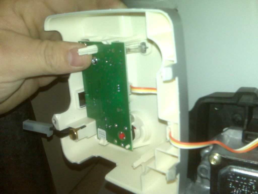

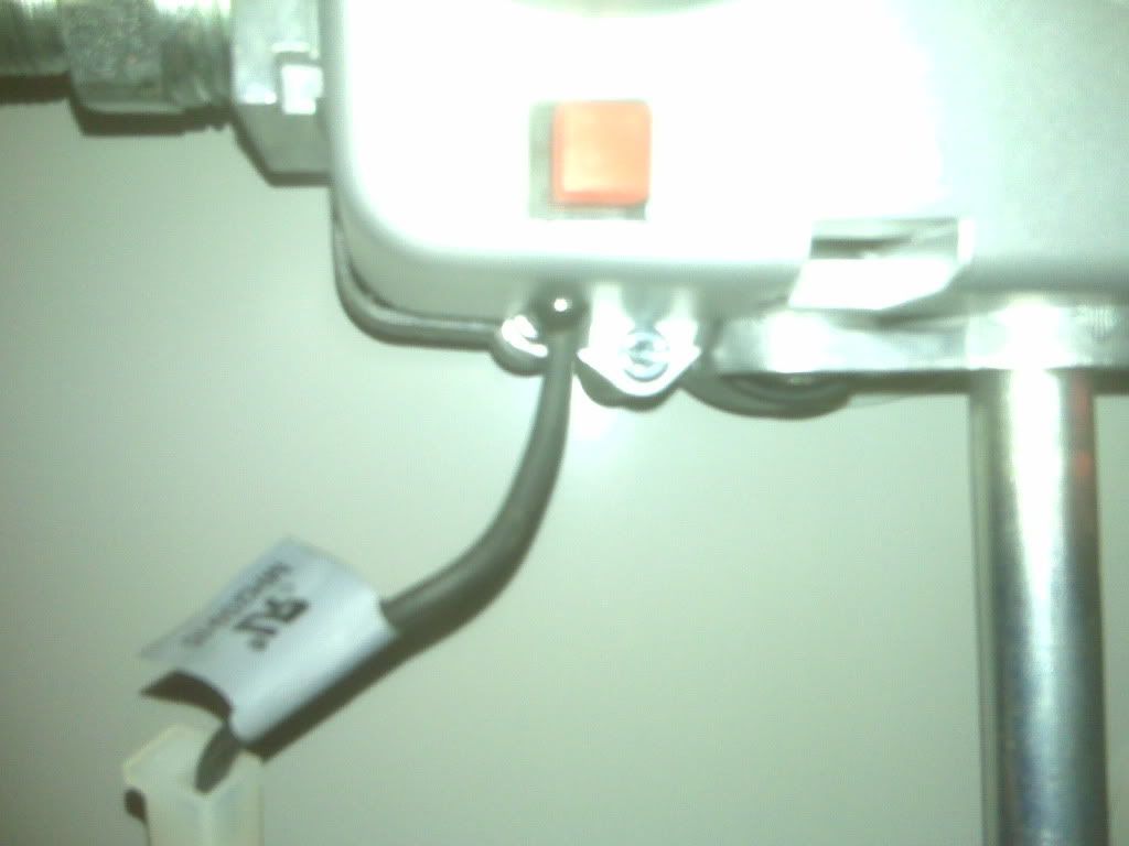

    I have installed two of the new Bradford White Water Heaters with the new ICON valves. #2 had a five blink fault right out of the box (water temp sensor fault) so I thought I would document the teardown
    #1 Bradford White ICON valve assembly
    #2 #15 Torx or flat tip for cover screw removal
    #3 Cover removal (remove torx screw and depress 2x clips on top with a flat tip screwdriver) The small three wire connection that you see is the temp sensor wire.
    #4 Sensor wires plug into circuit board via a small connector that pulls out. You can only put the plug in one way so don't worry about it.
    To be continued...
    Re: Bradford White ICON teardown (temp sensor replacement)
    #5 Valve body has a torx screw that needs to be removed. There are also 2 clips at the bottom of the valve body that hold it in place, these can be released with a small flat tip screwdriver then pull the valve out at the bottom and slide it down to release it from the top mounts.
    #6 The valve body is removed. The valve body has 3 roll pins that stick out towards the front and will need to be protected. If they bend you will have a hard time getting the cover (with the circuit board) to remount.
    #7 The temp sensor being removed. The sensor is mounted to the white plastic carrier that slides into the well. Sensor orientation is important (make sure it points to 2 o'clock when you put it back)
    Lessons learned:
    - Be VERY careful when you go to mount the cover back over the valve body. Be gentle and make sure the roll pins from the valve body are lined up properly. If you force it the pins will break the circuit board.
    -I had a very stubborn leak on the burner supply line at the valve body after reassembly that took me six trys to get sealed. This connection does not want to line up properly so watch it
    Total time to do this job is about 15 minutes once you know how to get everything apart.
    Bill
