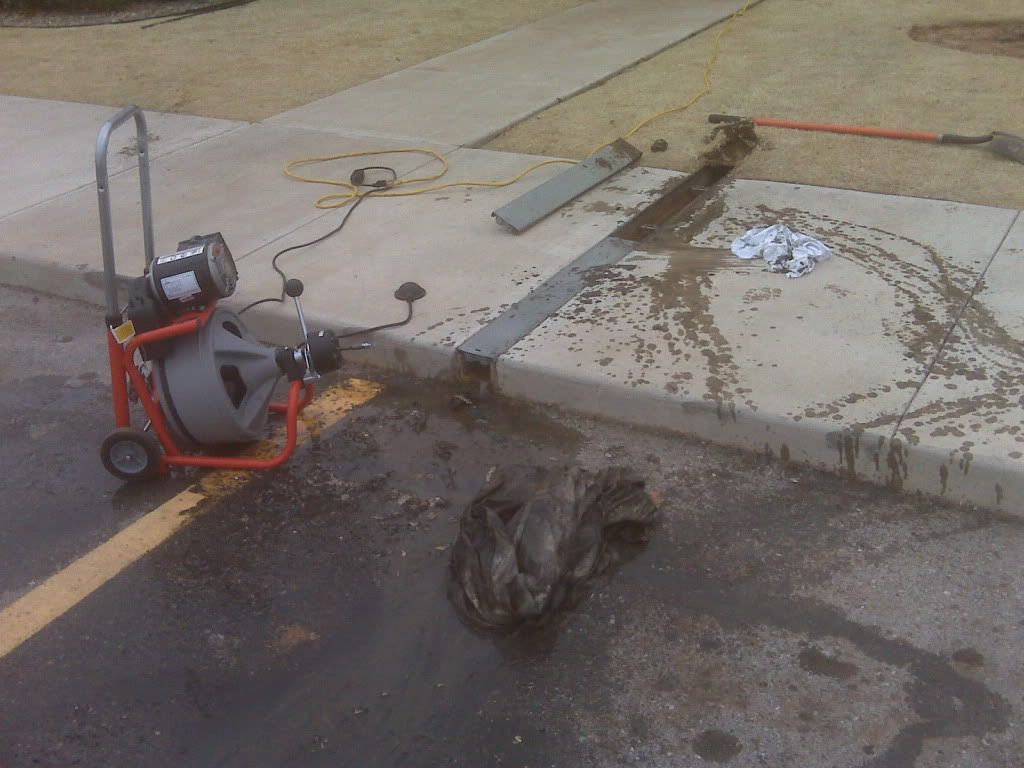

    Working at my favorite restaurant and the grease cleaners left me a present (rooftop drain line)
    I would have used the mighty K-60 but I did not want to get my hands dirty, rotten grease is the worst
    Would this have been a prime jetter job? How do you tackle commercial grease issues...

      Grease guys were on the roof cleaning the grease hoods and changing catch pads they washed all of the grease down a rooftop drain where the curds got caught up on one of their pads that went down and stopped everything up.

        It would have been very impressive if you drug out that giant greasy towel..

          It would not fit through the grates under the sidewalk so I had to pop the grate and pull it up and out via screwdriver. The spade cutter got caught up in it pretty quickly so I pulled until it jammed at the sidewalk transition.

            Maybe the plumbers should start tieing the roof drains into the sanitary sewers now huh? Hope you can get all that grease off sidewalk.
