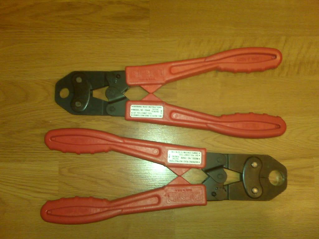

    I decided to buy a couple of new PEX crimpers
    -When is the last time you calibrated your crimpers or used a gauge and checked a crimp??? Maybe it's time huh?
