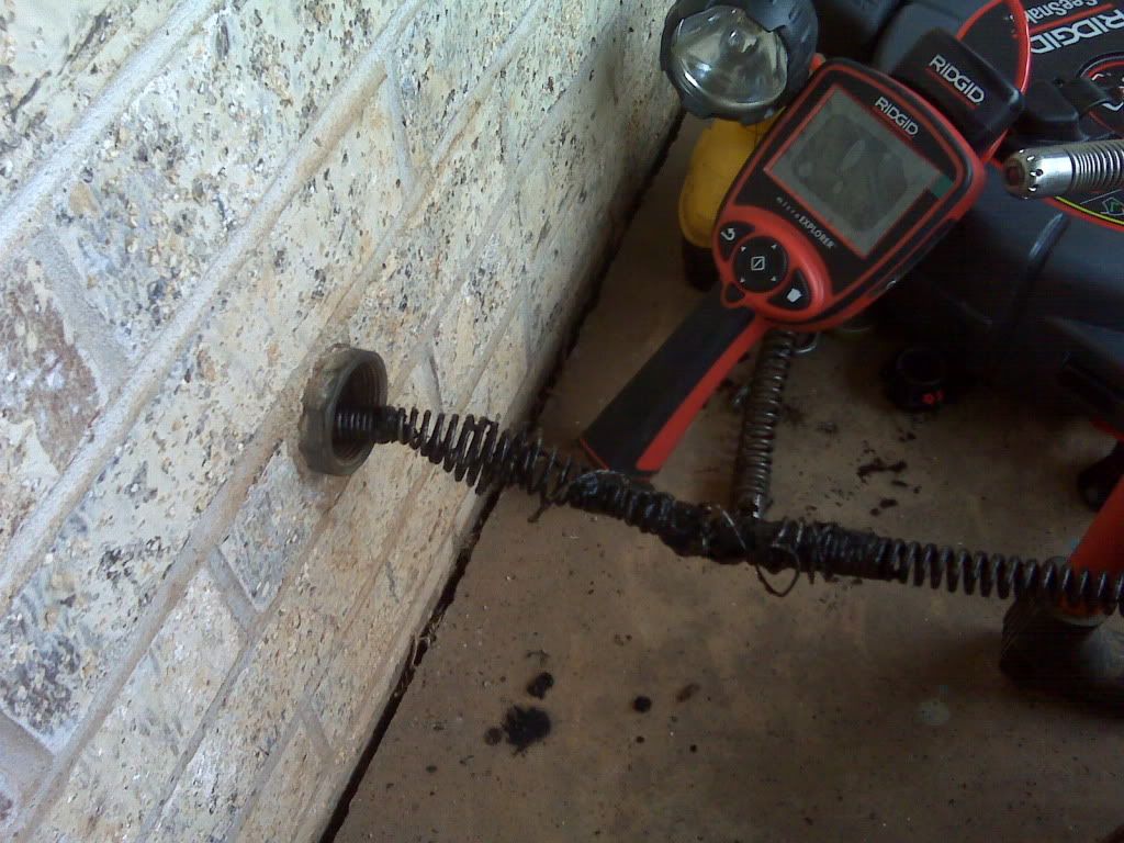

    Washer / Kitchen sink draining slow so I send in a bulb to get a bite of the stoppage I sent the head out about 20'....
    Here is what I find when I bring back my cable (It's gonna be a bad day in Hacktown)
    Hmmmm, I wonder what I wonder what happened? I did not notice anything while going in.... I better get out the MicroReel and try to see what happened...
    Now how the hell did a bulb head get flipped in a 2" CI Line and why did I not feel a thing
    Well I broke it so I better go and get it.... My K-400 is now down for the count. Thank goodness I carry 50' of 5/8" OW and have my trusty K-60 to spin it.
    Made the catch
    Here is the head after cleaning it up a bit...
    OK, So the head w/ connector broke at the weld... I'm still puzzled as to how I could flip like this and not feel a thing...
    All's well that ends well

      Great post thanks. I have broken that same connector off in the past. But yea it is puzzling that it flipped like it did and you not feeling it.

        With a wall mounted cleanout the job should have gone pretty quickly so I pulled out my small drum. A K-60 will spin 5/8 OW but it is waaay to powerful for it and you will end up kinking up your 5/8" when you load it up...

          I had to have gone into a larger branch and doubled back is all I can guess I had a hand on the cable as I was going in and comming out but was using the powerfeed...
            Re: If you break it go and get it...
            Bad temper/weakened steel due to HAZ at weld? That was always my fear with welding them and why I went to locktite. Dunno how you got it pointed backward, except if it bound up a little then snapped it'd be jumping all around.

                  And that looks like a B.S. premature break. Cable old? Brand?

                      Two month old original K-400 cable (3/8" IW 75')

                        That was the Microreel (100') without any guides.

                              Yes, this cable was welded.
                              I really liked the flexability of this cable (which is why I would not use it on larger then a 2" line)
