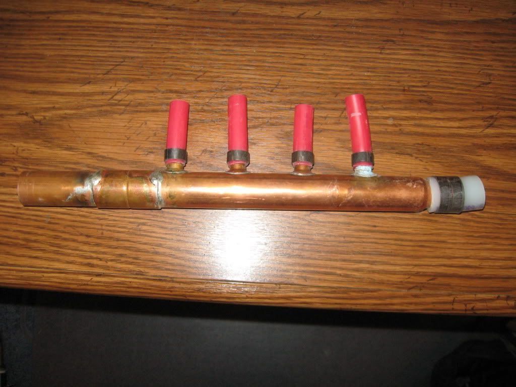

    I got called out to a house a plumbed around three years ago for a leak. I went into the crawlspace and found this pipe was leaking at the port on the right.
    Here is a close up of the leak.
    The manifold is a Sioux Chief manifold. The port that started leaking was the one that had the recirc. line hooked up to it.
    Did that constant water flow cause this to erode away in just under three years? That is sure what it looks like to me, but I wanted an outside opinion.

    Do you want to cut it open and get a better look?

        It has a Grundfos on it. When I looked at it today, it was set to run 24/7. I thought three years ago I set the timer on it to run for less, but I don't remember for certain.
        I did think about having it cut open, but I think for now it will sit on my shelf just in case I need it for evidence later on.

            hard to see. is the copper worn thin and leaking or was it the pex crimp joint?
            is that manifold factory soldered or brazed? is it a t-drill joint?
            is the leak from the 1/2'' barbed stub or copper joint?
            have you contacted sioux chief for their opinion

              Chemical interaction of the piping leaching through the water when it passes through the manifold.

                  As the only one of the four that leaked was the one circulating, I suspect the leak was caused by "erosion corrosion." The sudden change of direction at that last fitting, with constant circulation, strips the copper of the thin layer of oxidation, and it decays WAY more quickly. (Think of the nice, clean guardrails along a stretch of straight road, and what the guardrail looks like right at the curve.) I look forward to "comments!"

                    seems plausible to me...

                          By reducing the velocity of flow on the return portion of a circ system you will reduce the cavitating effects.
