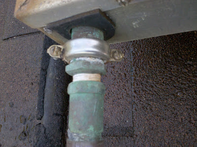

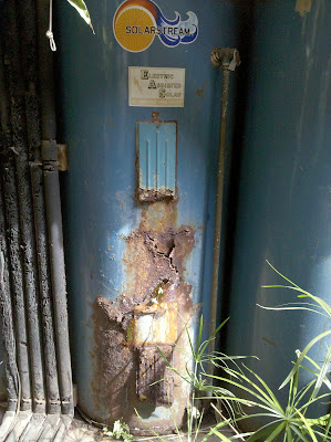

    I couldn't believe it. I got a call to isolate a leaking solar water heater that was one of 10. I got there and they all looked like the one in the picture and were all leaking! This one actually had ferns growing out of it! I called the property manager and asked which one of the leaking water heaters did they want me to isolate... They said which ever leaks the worst. Being as they are all the same age and leaked about the same I just closed my eyes and pointed. The system also had solar panels with very odd connectors that I have never seen on solar panels before either. They almost look like small victaulic fittings. One of the connectors leaked and I couldn't cut the connector off and sweat a fitting on because it was an odd size like 7/8 or 13/16 or metric . I soaked the rubber in PB Blaster and reconnected it, it dripped but wasn't as bad. Gave them a price to replace the whole system. Interesting call to say the least.
