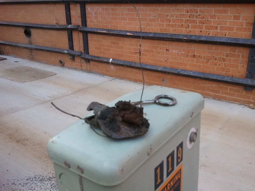

    Customers sewer is clogged... I work it with everything I have and cant even get it to pop, Gotta dig
    Run Sonde and my trusty scout but she starts doing some really weird things outside so I decide their must be something radioactive in the ground when I realize my sewer problem shares an Alley with an AT&T building
    Oddly enough my Spade comes back filled with dirt and a Bit of Phone cable... This can't be good...
    Call my favorite excavator and get the locates... The phone starts ringing It would appear that the city is very unhappy that I'm going to remove their new concrete since they recently relocated all of the overhead utilities underground... AT&T was also not happy as they have a rather large fiber bundle that they also relocated when the alley upgrade was going on (though it was not located until the remark after concrete was removed)...

        Was there even broken concrete from the original sewer? Or was it cut then nobody remembered to re connect it?

            they wanted to use the drain line to run new phone lines and save them money on digging up the roads
