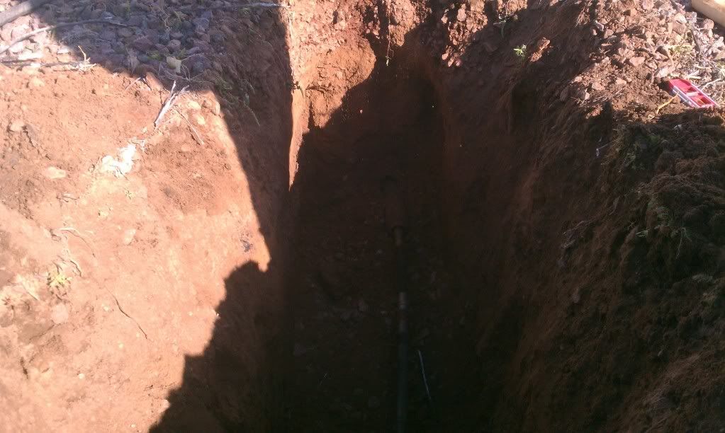

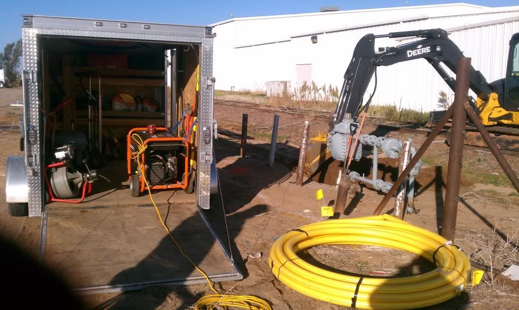

    I had a 2" service to replace today but had to go under a train track of all things.
    I was in a bit of a confined area so a friend suggested I use his "Mole", For those who have never used one it is basically an Air driven slide hammer inside of a torpedo shaped piece of steel. It made a 3" hole about 20' long in about 5 minutes. I was impressed... (The Tool is made by HUDCO Manufacturing who call it a "Piercing Tool")
