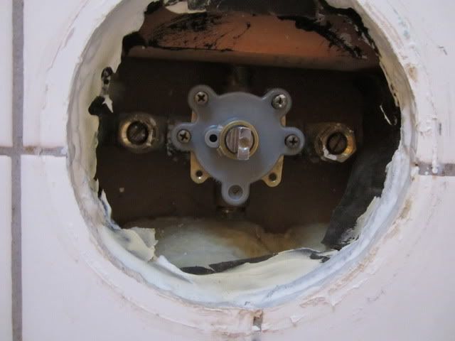

    I am trying to track down repair parts for a pressure balancing Price Pfister shower valve from the late 80's or early 90's, and am not having any luck with my usual sources.
    The number on the valve itself says Shower 7196.
    Any help would be appreciated.
    Here is the part I can't find.

    It looks like a flowmatic. Try PP 900-0220 (?) cartridge. Very pricey so shop for the best buy. It seems like 20-years ago they were still almost $40 at the wholesaler house.

      Not a Flowmatic. It is an old type 08 BoduGuard. Need to call PP, because which stem it uses depends on how many screws hold the cart. in....4 in your case.
