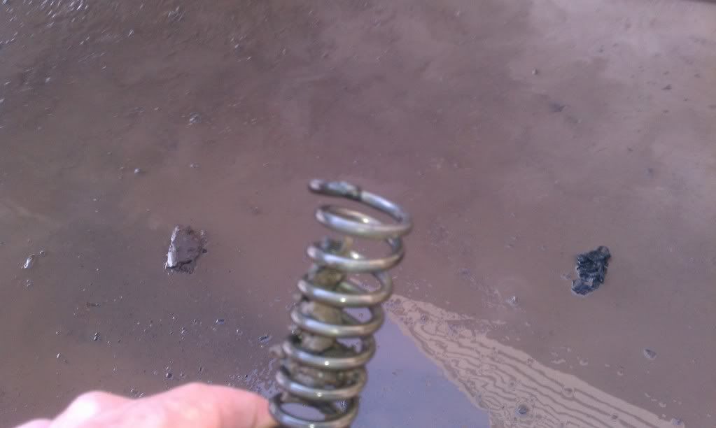

    4" clean-out w/ K-1500 and a retriever. I became lodged in an obstruction, I worked the cable for about 5 minutes and was honestly surprised it came out so easily... This is what comes back!
    What the He@$ I just bought this Ridgid retriever last week from my Ridgid dealer, No matter what you gotta go get it if you leave it... Gotta cut.
    Gotta Dig
    I should be a mud logger... Camera's can't see anything and I cant get folks to stop flushing so I'm a getting madder by the hour...LOL
    GOT IT!!!

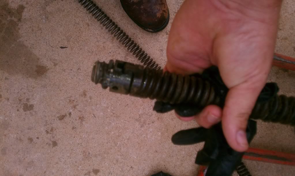

    The retriever managed to screw itself through a rubber FERNCO that was not cemented in, it was literally screwed right through the rubber. The bigger question is why would this new tool fail.
    The consensus is that this auger weld was too hot and De-tempered the steel at the weld edge allowing it to snap under load.
    Should the customer get charged for this?
    What can be done to prevent this from happening again Ridgid?

    bill, it's a toss up between the auger breaking and the screwing into a rubber fernco.
    i never use a factory auger anymore. it's now my reverse auger that never fails. i know for a fact that the reverse auger would not have broken off. believe me i've broken 4 augers in 1 day on a job. in the couple years i've used my reverse auger, it's never broken.
    honestly with a 4'' line, i would still have used my spiral rootsaw to grab wipes, and sanitary products. remember that the 1500 open wind cable will grab everything it spins into. not just the auger head.
    i think that with a different choice of cutters, you would not have poked a hole in the furnco. we use them out here all the time.
    not sure how you can/ will bill this one. sorry. i have no good answer to that one.

      I guess my point is that I have screwed through FERNCO's, Broken Clay, rotted cast iron and been jammed so bad 4 grown men had to pull the cable. I have retrievers that have been with me for years so to have one fail on it's first use is a major disappointment....
      I use a reverse Auger with my K-50 but have not set up for it with my K-1500:-)

            I have snapped welds on both designs of Ridgid augers twice under light conditions.
            4 welds snapped.

                Join the club Bill every time I break a cable or cutter it is alway at the weld which seems to be the weakest point I can remember years ago the cable was pressed onto the fittings and wasn`t welded and would like to know why Ridgid welded them

                    I bet the Pressed on heads are gonna make a comeback (Rick may not even have one of these )... Now if I could just get them for the K-1500

                            Imagine how many hundreds of thousands, maybe millions of those kinds of heads are made every year bill. So ya got a bad one, and it just happened at the right job to make accidents look bad. I've yet to break anything with a ridgid sectional. Have straight snapped a spartan drum machine line though.
                            But I'm still more partial to drums over sections.
