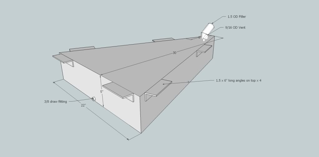

    OK I never have to calculate this stuff any more LOL Can you guys give me the Capacity in Gallons ...
    Thanks ! Dave

      I came up with 7.14 gallons
      figures, I used, 22" wide 30 tall, 22x30= 660 since it is triangle, take half, 330 x5 inches deep, =1650 cubic inches, a gallon is 231 cubic inches, divide by 231=7.14 gallons,

        Thank You :-)
