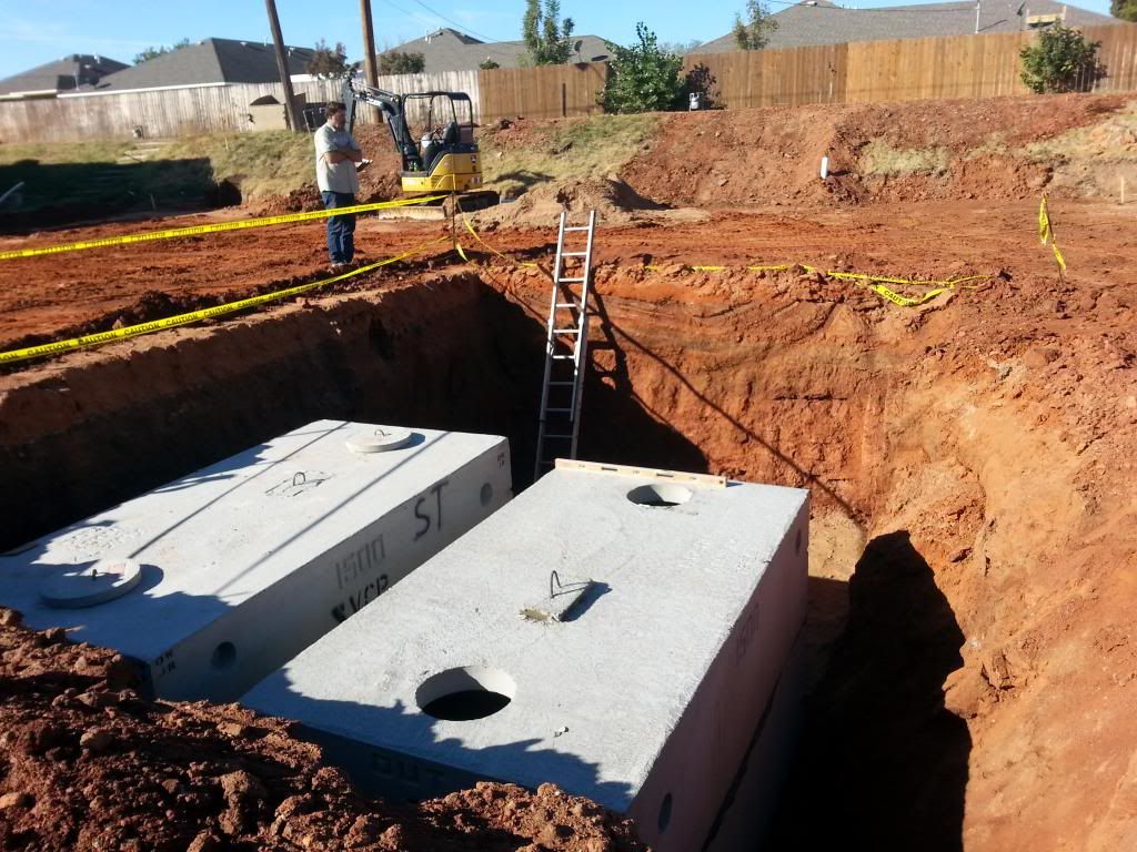

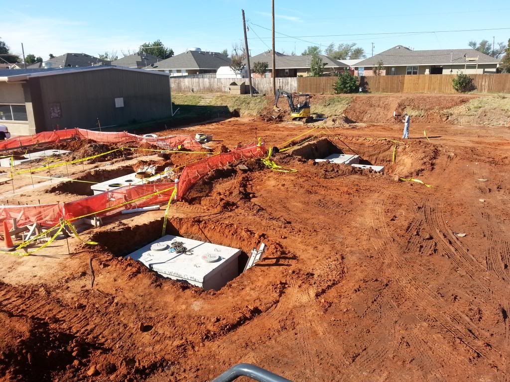

    Since its not something I see everyday I thought I would share this project (Recycling Car Wash) This particular design uses a .5 micron filter system drawn from (4) 1500 gallon tanks installed downstream from the wash bay tanks. Did i mention this car wash is also going to be capable of running from a well as well as city water.
    10000 gallons of tanks for a 2 bay car wash:-)
    Tank delivery day (Waiting on 2 more 1500 gallon tanks to arrive)

    Look like 1500 gallon street rated septic tanks. Yes?

      Yes, all are septic tanks with the exception of the well water cistern.
