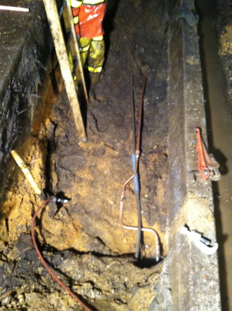

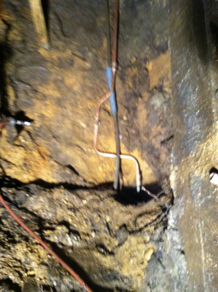

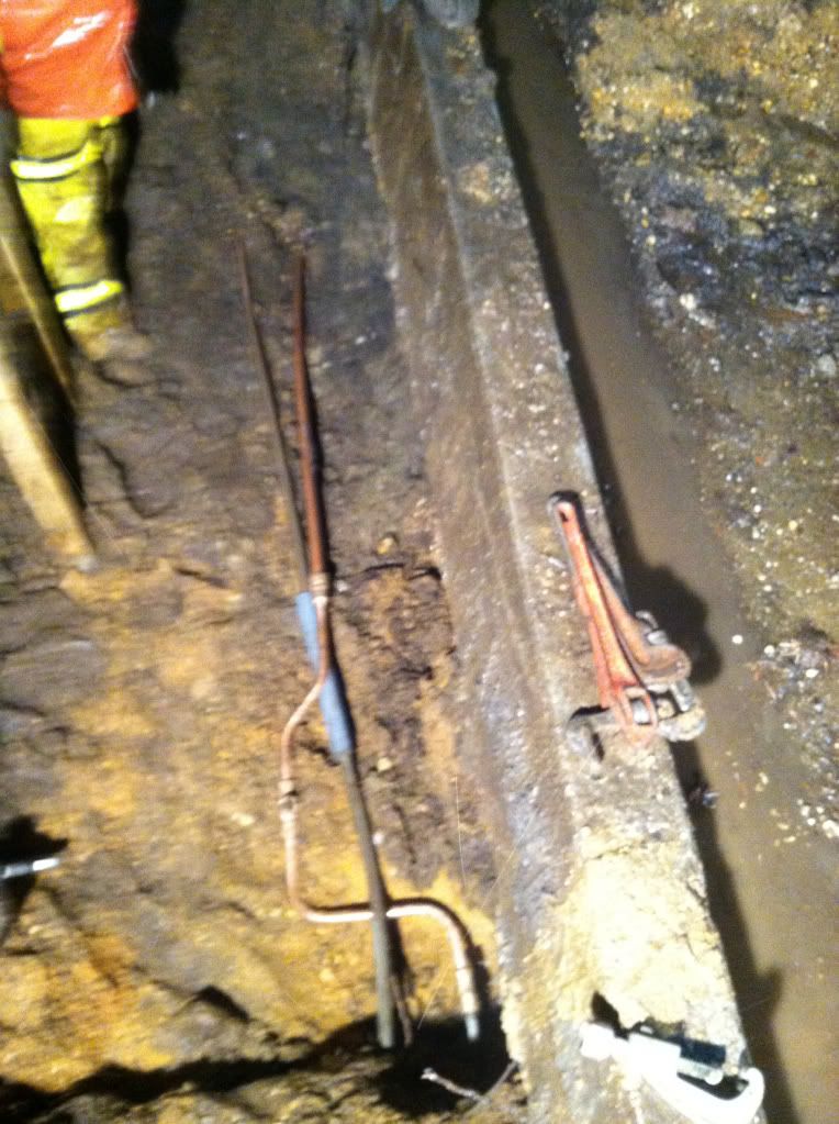

    I had a spaghetti service today that was leaking and needed to be replaced. Found numerous pinholes in a 3/4" section of the service. Crimped it no good crimped further back, it held so I busted out the super freeze. Saved us from a 8 valve shut down and putting 200 homes without water. I had to offset the new copper so I could bring a curb stop to grade away from the curb line. Kept finding pinholes, looks like Swiss cheese. This was 80' away from where it was tapped on a state road. The service continues 135' till the meter pit. Oh did I mention this was mostly dug by hand because of the gas main and two services. Over it went ok I guess 5-1/2 hrs of OT and a cold dinner haha

    Must be the soil, Right ? Save these pictures and do a mailer in the area for future work ! They will save Your refrig. Magnet ! Those pix will put the fear of God in them !
      Re: Water service from hell, super freeze saves the day
      Great use of the superfreeze. Im sure the 200 other homes are greatful for having water before the holiday.
      I once used a bolt cutter to crimp off a 3/4" copper line and it held great. Was able to freeze the line and replace the crimped section. Worked like a charm too.

          Too bad you didn't have a suck truck on that job to make life easier. Our city water dept would have called the Vactor crew in to hydro vac the excavation before they would hand dig if they could not use the back hoe.
          It's amazing what the Alkaline soils do to copper and cement pipes.
          I don't know if our city water department freezes lines to fix services, usually they turn the main valves off or down and drop off a tanker trailer on the street as required for customers to use.

            Nice bends on the copper! Almost looks like you used a bender.
              Geno
              I did use the bender haha. I usually keep a double 90 and a double 45 like you see in that picture already made up on my truck with long tails so I can cut them to size in the hole.
              As for using the guzzler/vaccuum truck, we are a separate entity from dept of public works. I work for a municipal water district. We only call the town or county when we have a main break and need the road salted. In this case we didn't want to dig up a main road to fix the leak that's why we did the crimp freeze and cut method. Normally when we replace a service we have to dig to the main anyway so we shut the service off at the corp stop.
