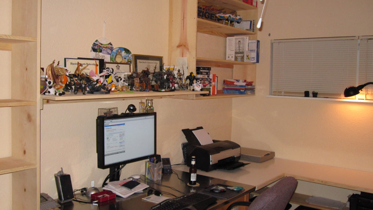

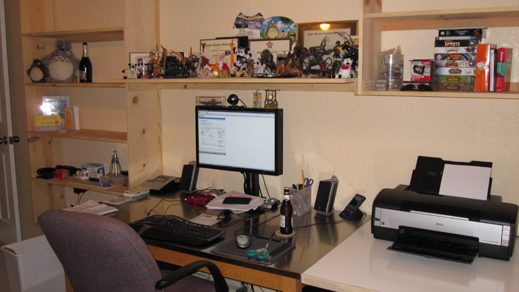

    Got to use it for the first time this weekend:
