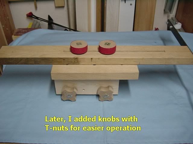

    Instead of making the traditional feather board I made it with rollers that have wide span and are holding the board very firmly pressed to the fence and pressed down to the table before entering the blade.
    Very easy to push the board and feels very safe...only one hand pushing and 10" from the blade, I change to push shoe.

    I like that set-up. As I was looking through the pics I saw the little wingnuts and was going to recommend something bigger....But, as I got the the bottom, I saw that you already thought of it.

        As you could see, I took the pictures when the unit was still a "prototype"
        On one of the pics you can see that it's held to the rail only with a clamp.
