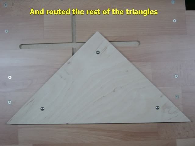

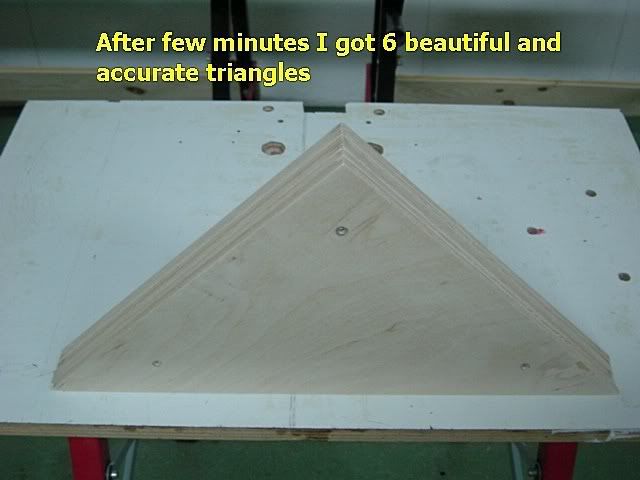

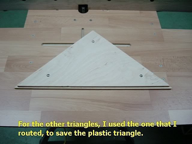

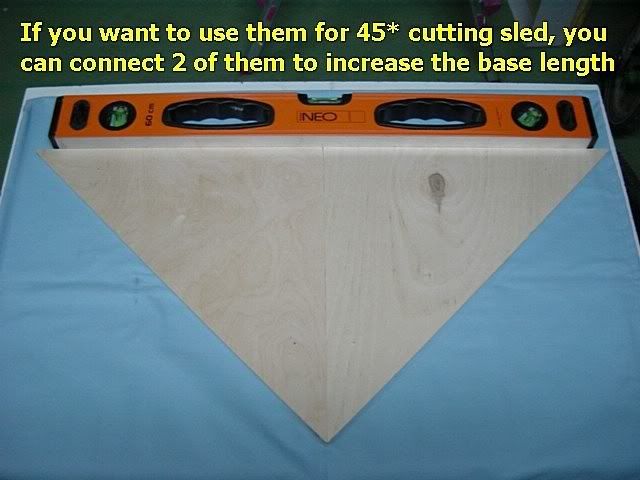

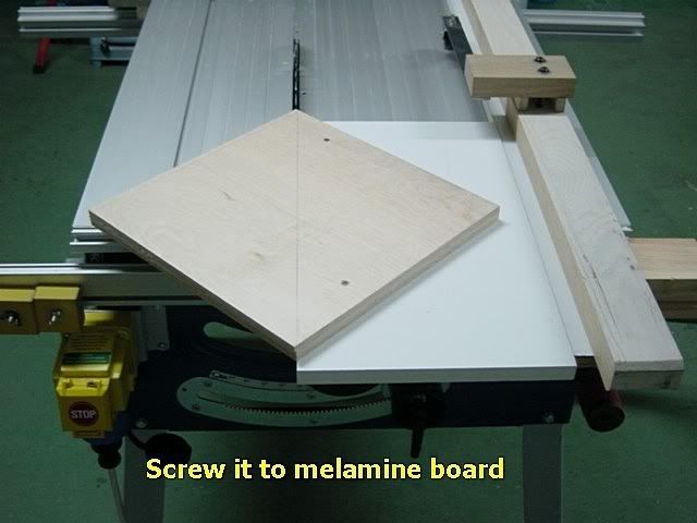

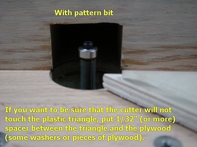

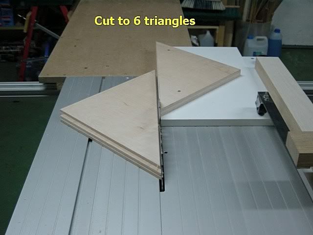

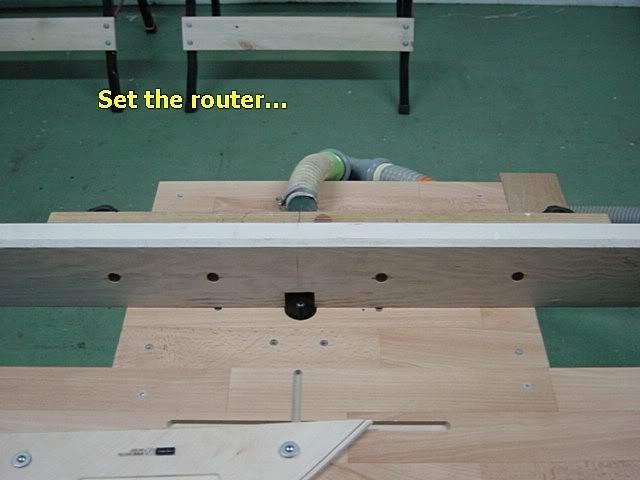

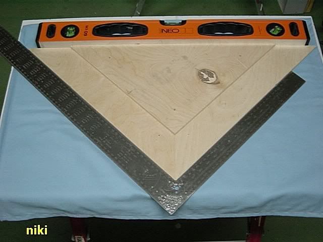

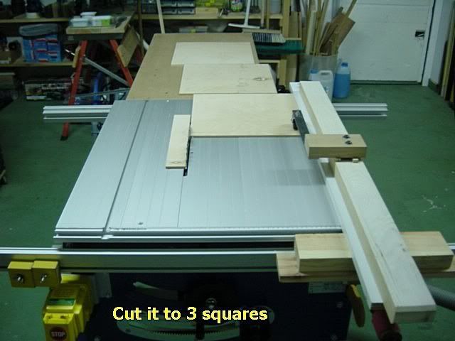

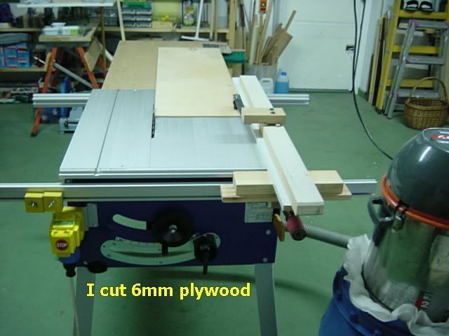

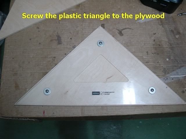

    I have two 45° triangles that are very accurate but, I don't like to use them for everyday work...
    So I "Copy" and "Paste" them to plywood
    I used 1/4" (6mm) plywood but you can use any.

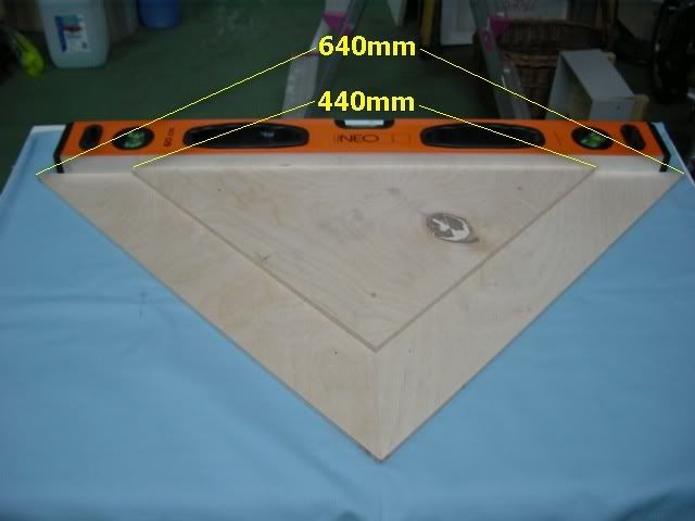

    Just to save you the calculations:
    440mm = 17-5/16"
    640mm = 25-3/16"
    Regards
    niki

    Very nice job Niki. I might offer one suggestion. Stack the pieces with Double sided tape and rout several at one time. I do that with my ZCIs. Saves a little more time.

      Thank you Papadan
      Well, you are so correct....I did not think about it
      Thank you for the so good advise
