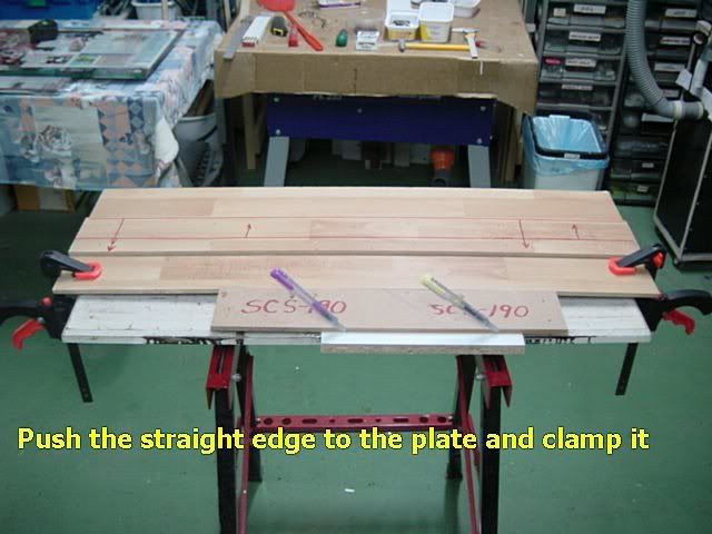

    Good day
    I have 3 CS's and each one with different "edge to blade" distance.
    Instead of making 3 separate guides, I made an "Off-set plate" for each of the CS and now, I can use only one straight edge for all the three.
    Sorry for the mm......
    25mm = 1"
    18mm = 3/4"
    8mm = 5/16"
    Regards
    niki

            Great information as usual Niki. but 19mm = 3/4"
            info for all: http://www.hoistman.com http://www.freeyabb.com/phpbb/index....wwtoolinfoforu --- "I like long walks, especially when they are taken by people who annoy me."
              Re: Circular Saw Off-set plate
              Thank you Papadan
              I know, but when I'm "translating" from metric to imperial, I'm trying to be realistic...you don't have 18mm (45/64") in USA.....actually I heard that the 3/4" plywood is not exactly 3/4" but a little bit less...Made in China???
              Same with the 6mm = 1/4" and actually it's less than 1/4" (6.35mm = 1/4")
              But I'm sure that you know it
              Regards
              niki
