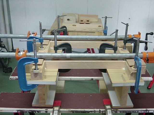

    We have some old table top and my wife asked me to make some small legs so it can be used as garden coffee table or just a table to put things during the barbecue.

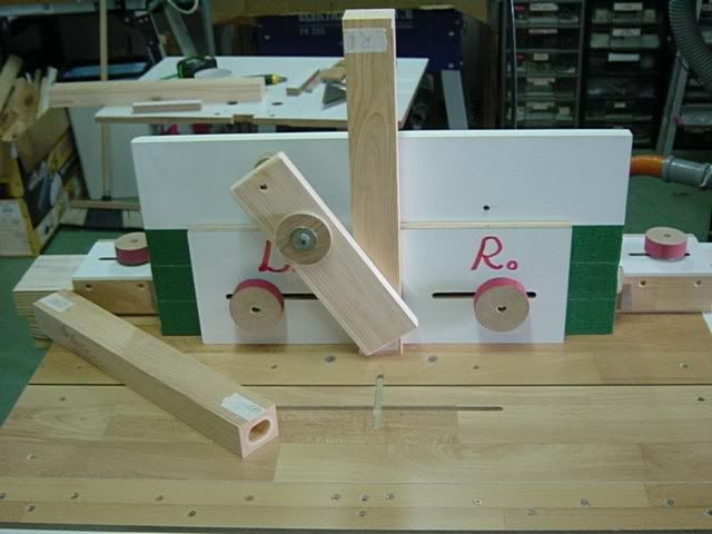

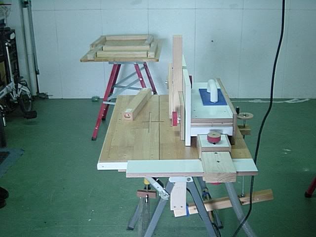

    That, gave me the chance to "play" a little bit with the new "Rolling mortise jig"...it works perfect...and fast.

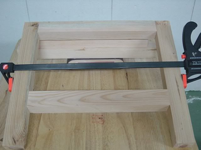

    I could screw the legs hinges to the top but, because the top was cupped, I made some extensions or elevations that I glue and screw to the top to straighten it (the table must be folded and stored for the Polish winter).
    On one of the pictures (in the garden) you will see the drill connected to a flashlight. This flashlight has a sealed lead/acid 6V accumulator so, it is used as "double function", light/drill.
    The legs were painted with two layers of impregnate and the top, with Wood/Metal lacquer
