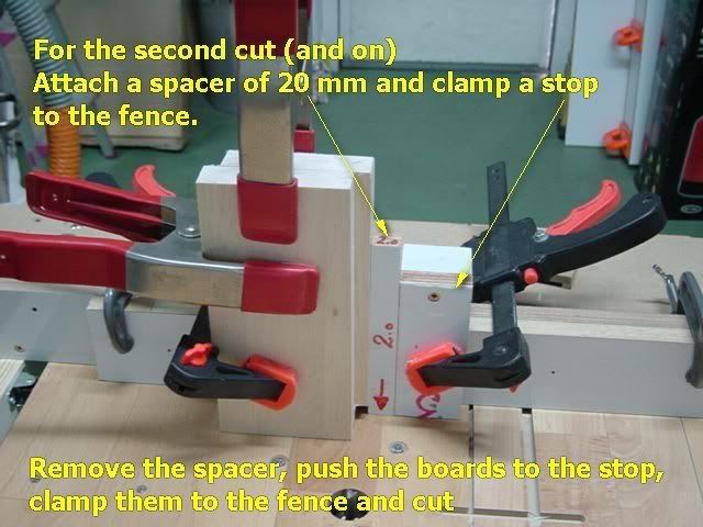

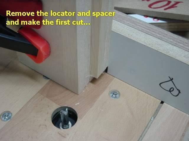

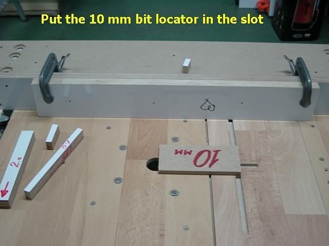

              So, the only alternate is router....I made this sled long time ago (almost a year) with intentions to use if for Finger joints and tenons....
              I have already the idea how to make it more simple, kind of the table saw sled (with locator) but I'm "employed" by my wife in projects involving concrete so ones I'm "out of the concrete", I'm going to make it.
              I'm not sure that this method is so much slower...as you can see, I'm cutting all the 4 boards in one shot (took me some 20~30 minutes) and I was very satisfied with the results.
