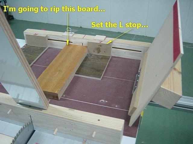

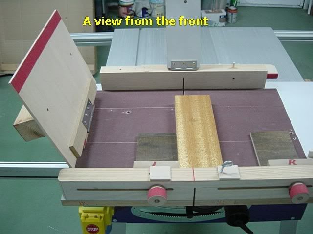

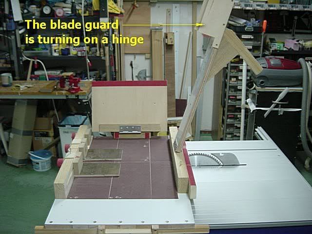

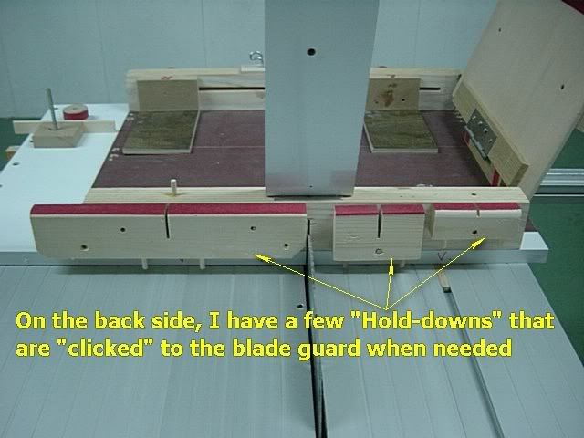

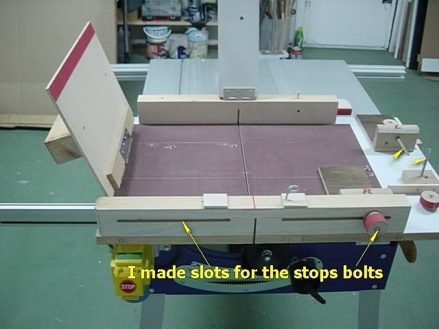

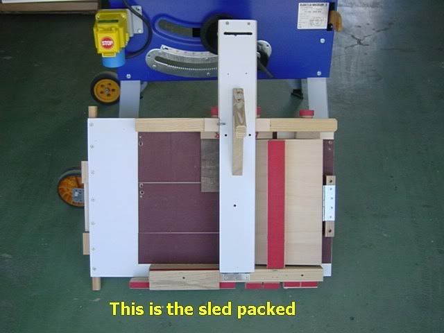

    This is the latest version of my sled

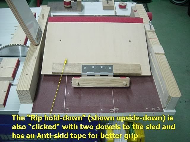

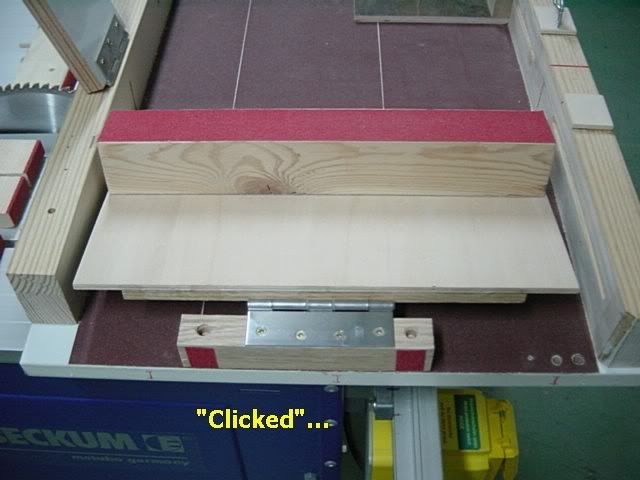

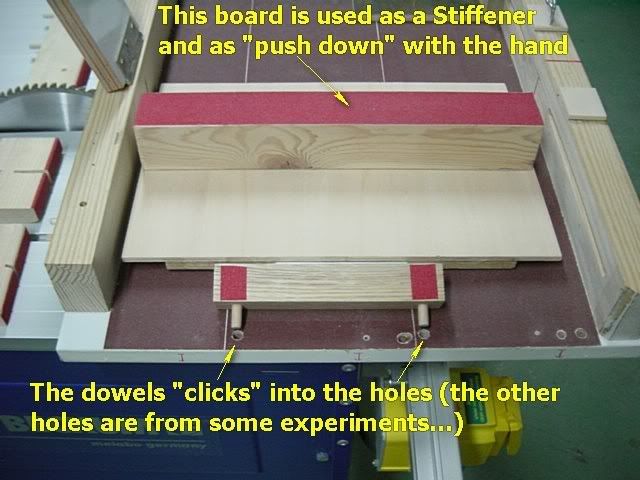

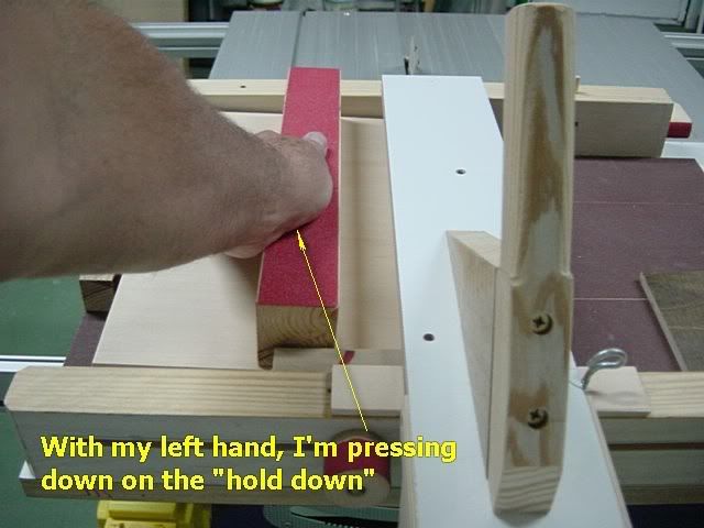

    I changed a few things to simplify the sled operation, like; I removed the "hold-down bar" and left only the "hold-down plate" that I press down with my left hand...
    Also, I didn't see any point of using the small "hold-down plate", the big one can cover all the cases...

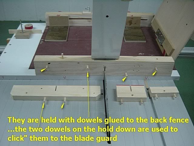

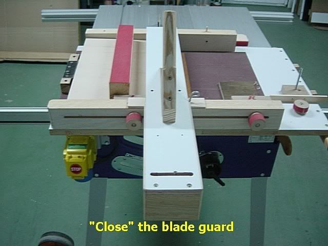

    So in total, it's a normal sled when you like it and, when you want to rip or cross-cut small pieces, you just "click" the "hold down plate" or the "hold down block" (to the blade guard) and go...
