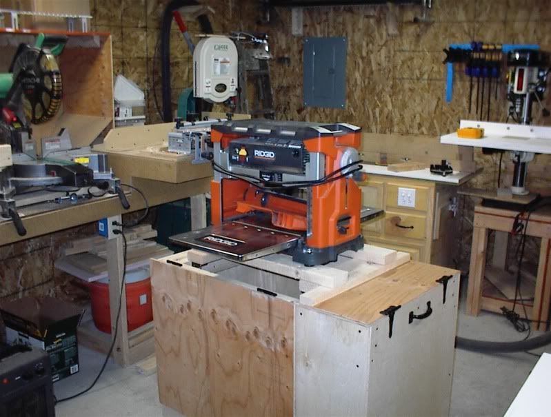

    Heres the planer ready for use.
    notice the dust chute tucked inside the planer,great place to store it.
    notice the area in front of the hand crank it makes a nice small table-its part of the lid.
    I "borrowed" the Idea from a sewing machine stand.

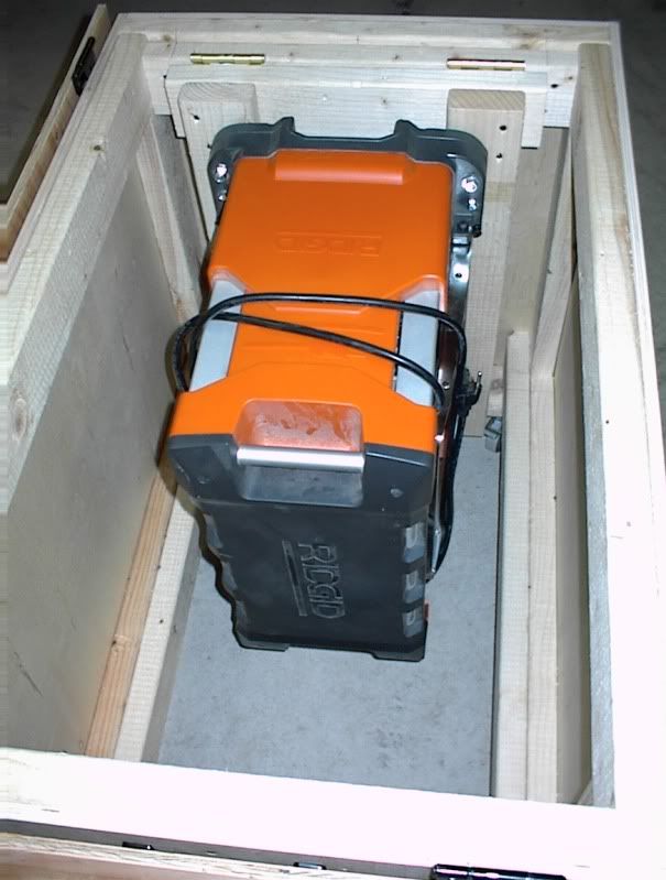

    and here it is Folded down inside.
    here we are looking down into the cabinet.
    notice the castor wheel - and the concrete floor.
    why give the sawdust a place to accumulate !

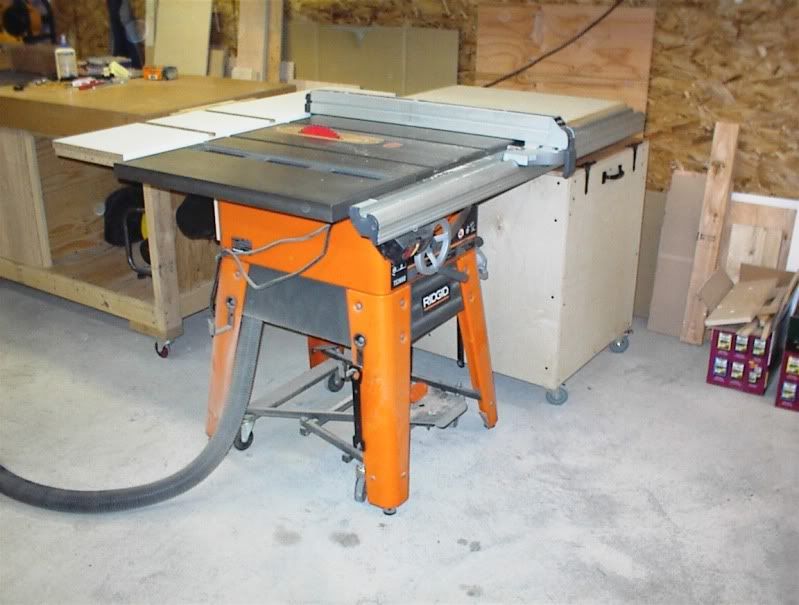

    And Ive reached my main Goal.
    It rolls under the right wing of my Table saw with a 1/4 inch to spare!
    Now you see it - Now you dont !
